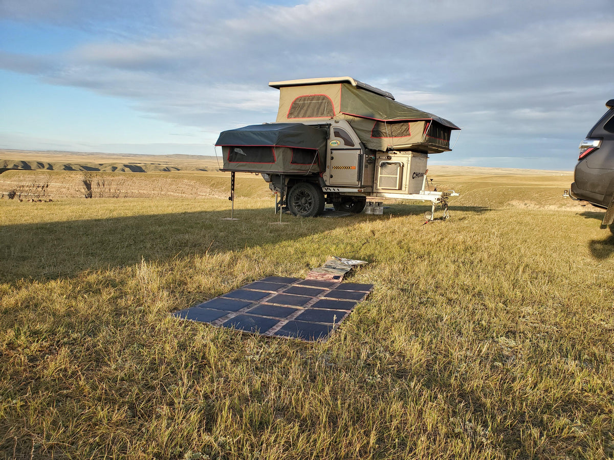

alia176
I have a small space on my camper roof. I want to put 800 to 1000 watts panels on the roof. What are the most efficient solar panels on the market?
I have another point of view from a different angle! You have a small space on the roof, which means you have not a lot of space for an optimum solar gain or wattage. Additionally, you have to mount them laying flat, which also prevents the optimum solar power gain based on the # of sun hours and seasonal angle of the sun. Most of us park our trailers under a tree so that the trailer stays cool during the summer.
So, with all that said, are you absolutely sure you can't go with a ground based solution that may provide the highest bang for the buck? Meaning, you can angle the panels throughout the day for max watts/hour. This takes into account seasonal sun location, and you can park under a tree for shade while the solar panel(s) are far away getting full sun.
Again, just another point of view.
