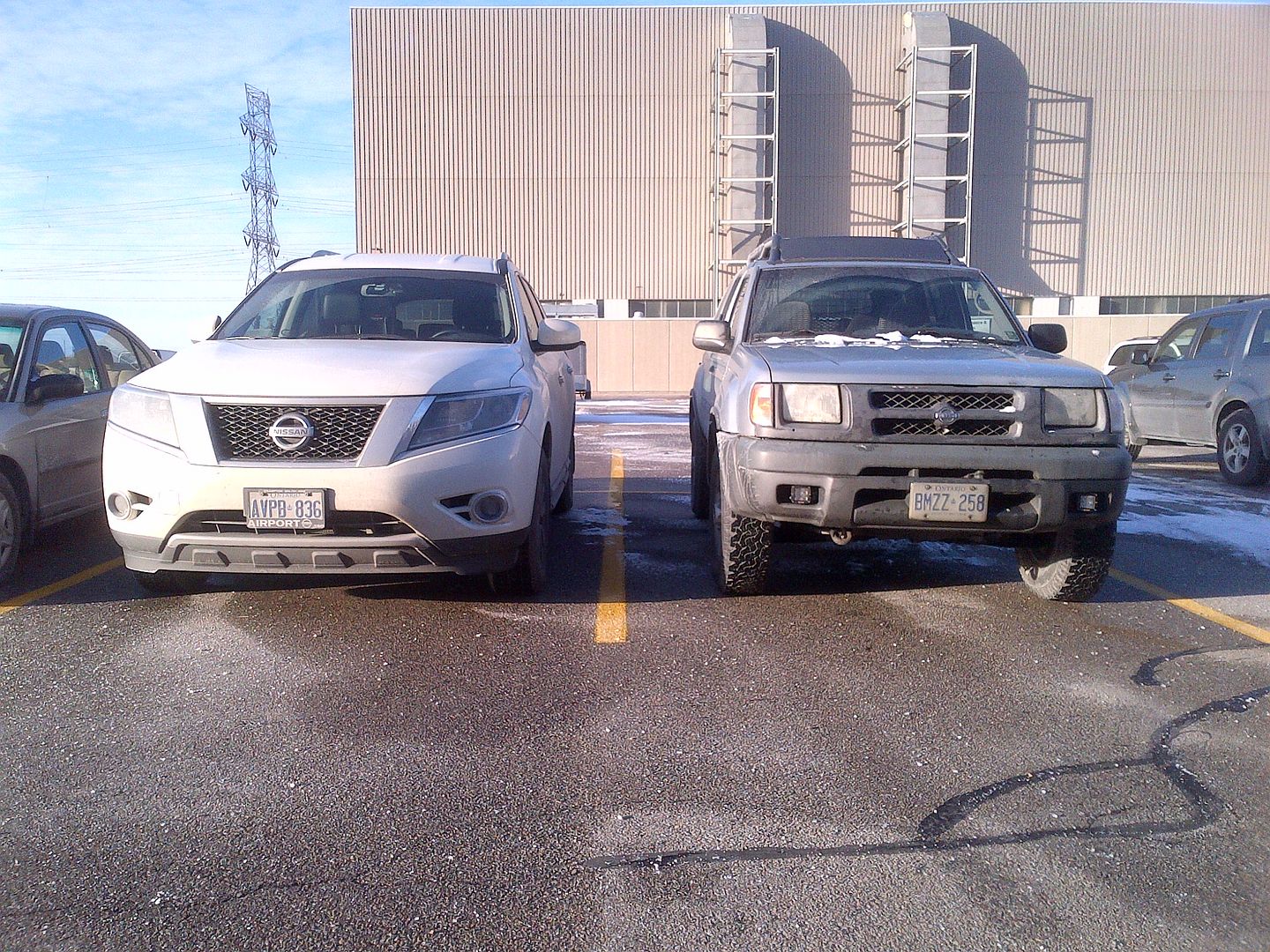

Parked beside a new Pathfinder this morning, once upon a time our lines shared some DNA, no longer. I realize I have larger tires than the pathfinder, but not by a huge amount (30" vs my 31.7") but the ground clearance on them is absolutely atrocious.
I'm sure a great vehicle for on road and well maintained dirt roads, but no longer the "pathfinder" it once was, sad
I feel the same way when I see one of these. Just makes me sad. Have you seen the new Patrol? Awful.
It's become a whale. Not that the R51s were light, but they weren't nearly as bloated or useless on anything more than a graded road. Though I'm glad Nissan is chasing marketshare, so long as they keep building an Xterra, I'm happy.
