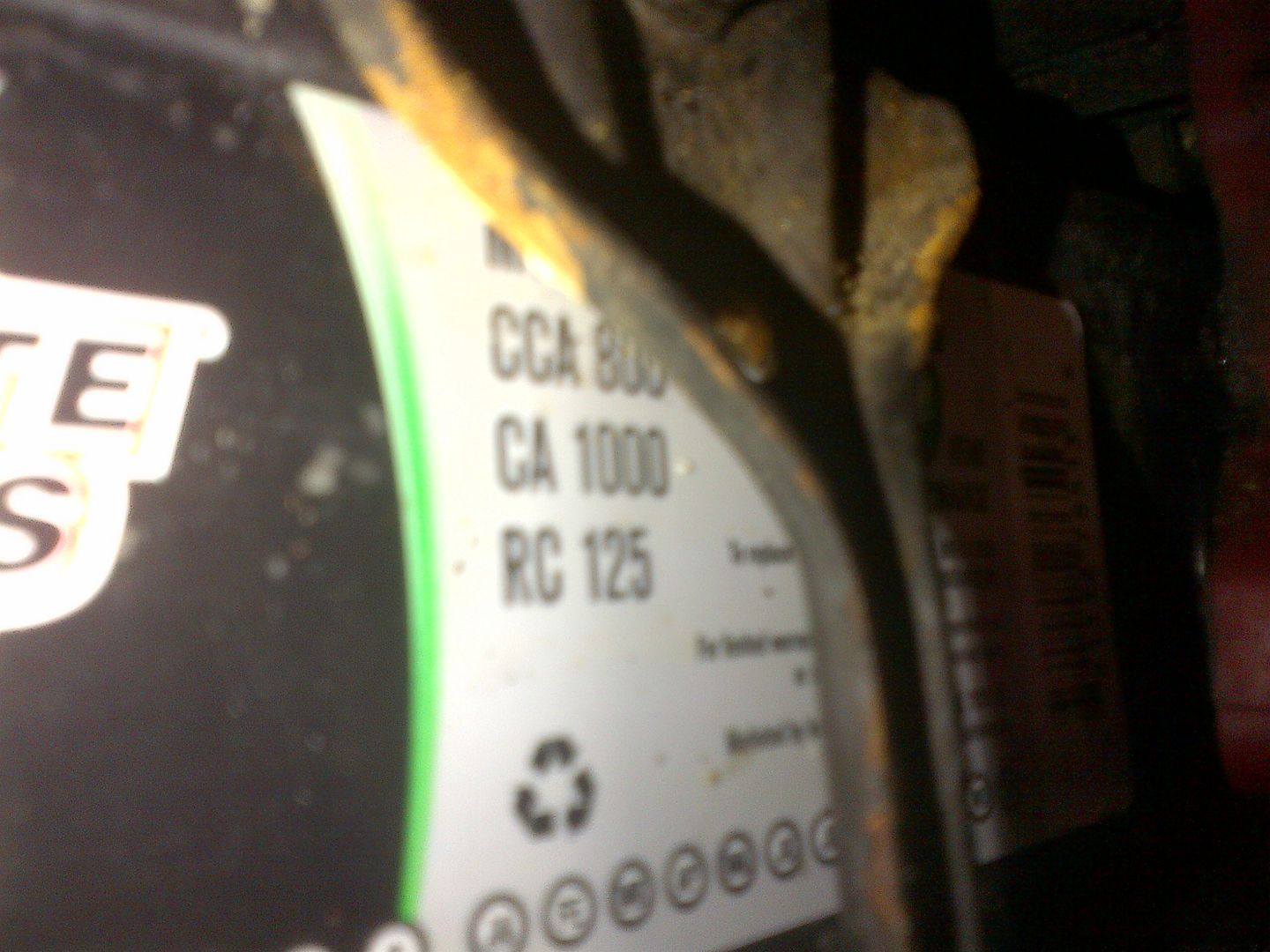

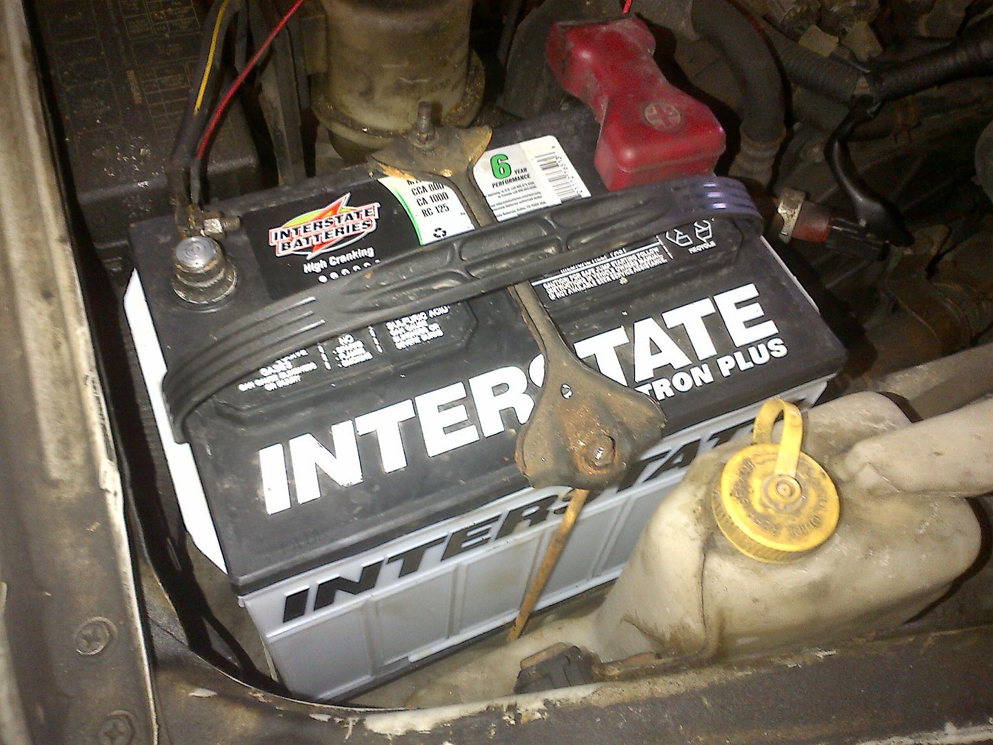

New battery, Interstate Mega-Tron Plus.
1000 cranking amps, 800 CCA, 125 reserve capacity

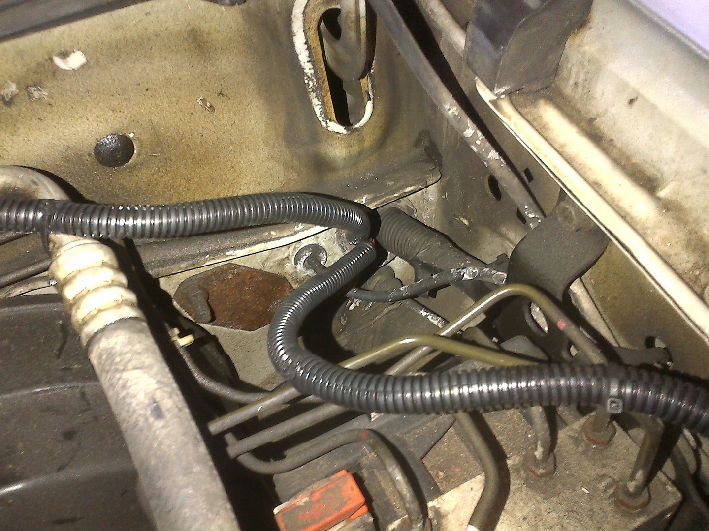

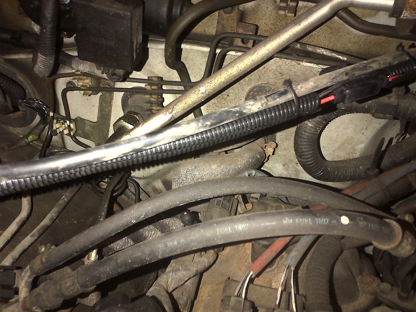

I also cleaned up the wiring for the rigid lights and ran some plastic loom to protect from the elements and any rubbing

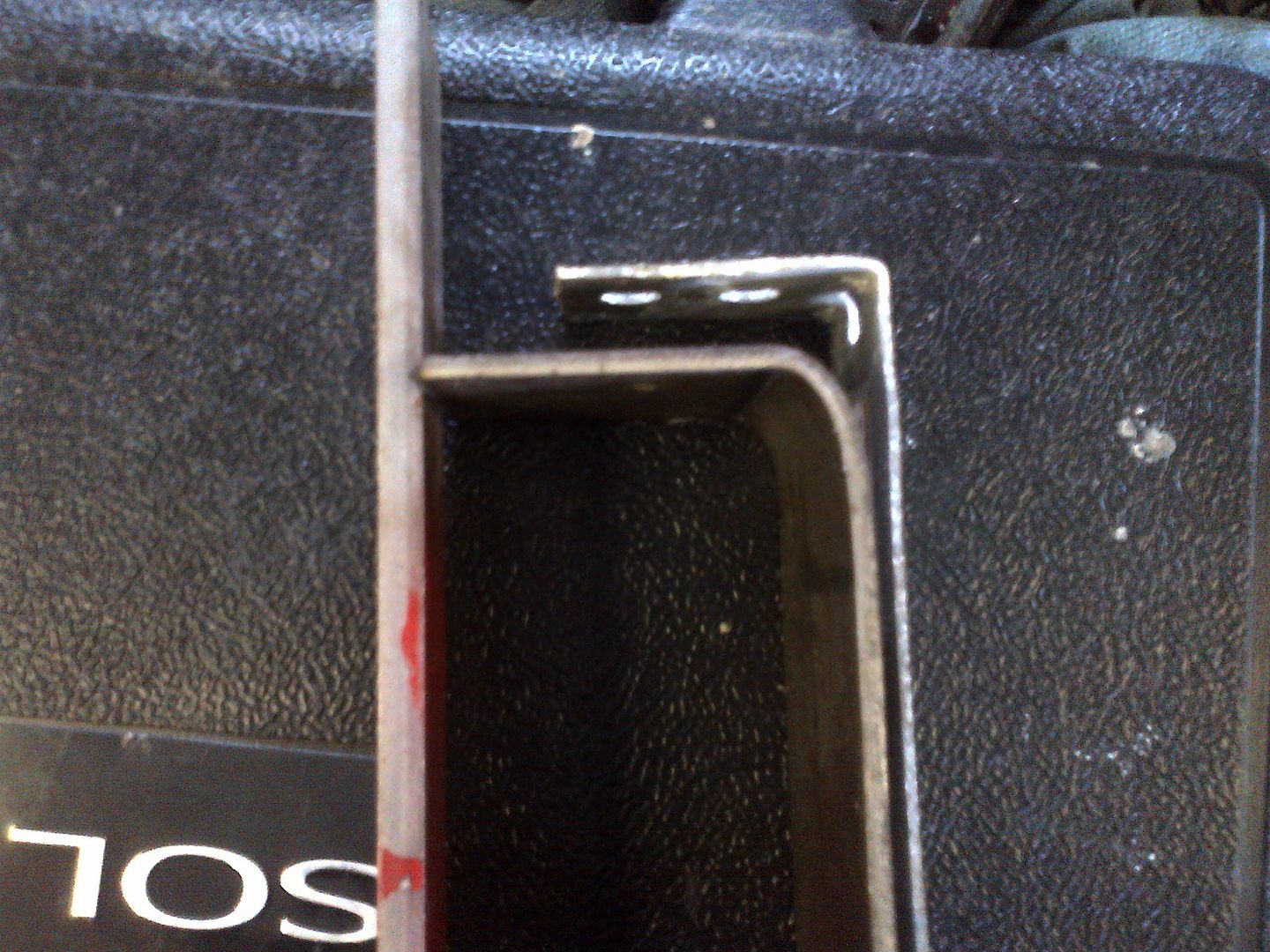

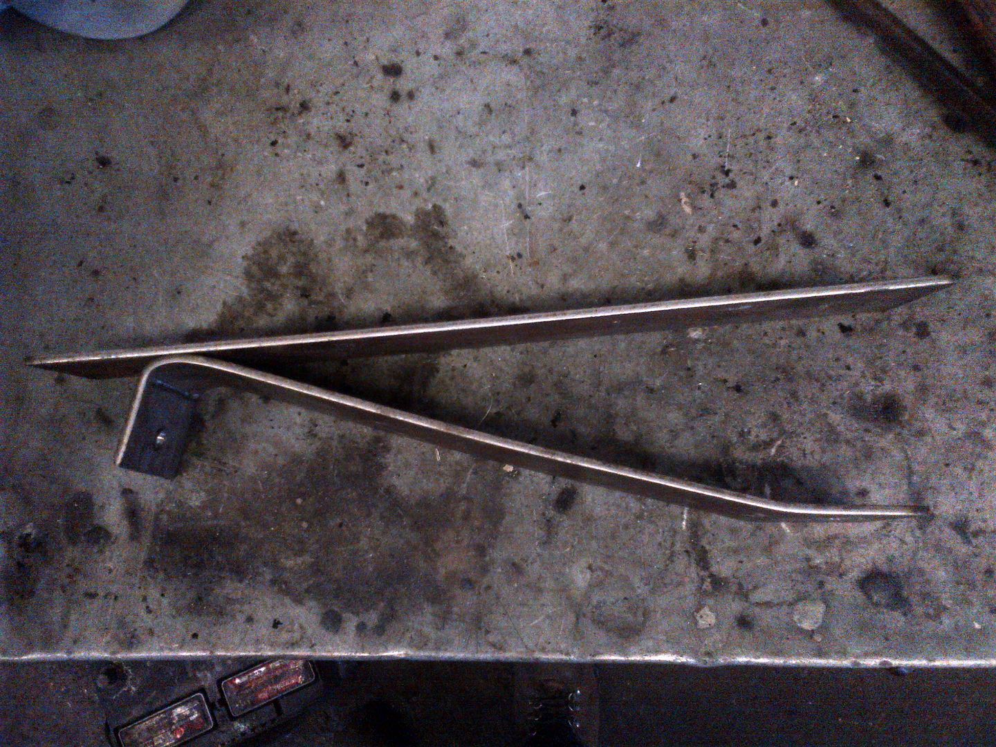

After that u wanted to change up the mounts for the lights, the metal that I had soured was too thick, and really touch got work with. Luckily in the shop there was some bar stock that was just about perfect.
Comparison shot of the three different iterations of the mounts
No one will ever accuse me of being a metal fabricator but they came out good enough, took a little fine tuning to get them in the properly, but you can't see them anyways so I am happy.
Bar stock vs completed mount

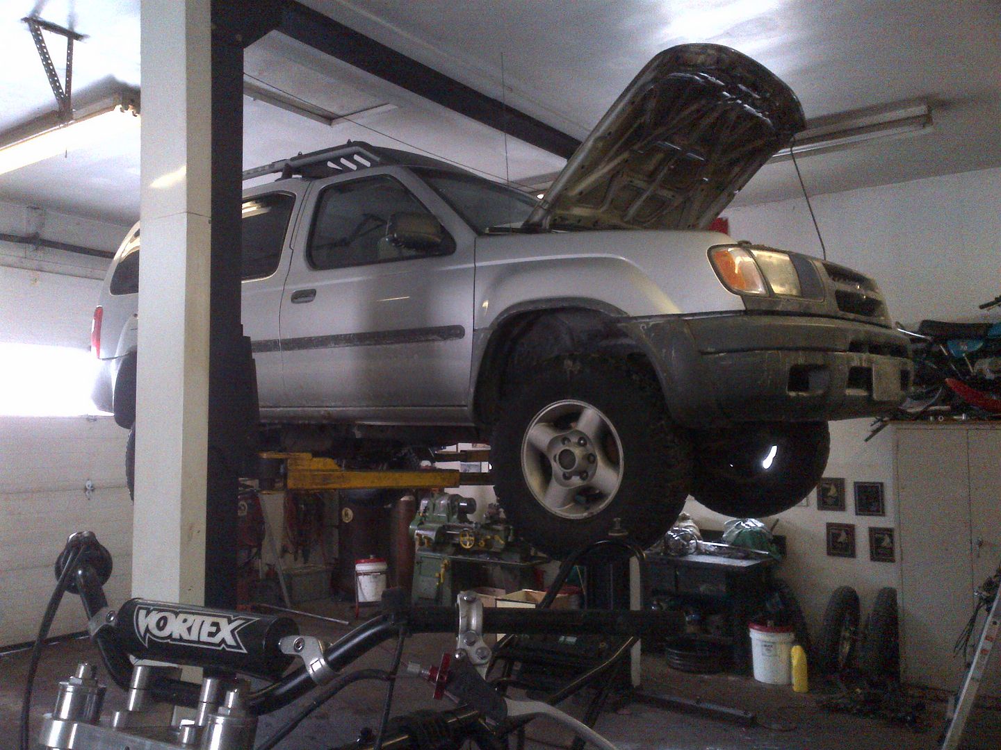

Couple shots from around the garage, truck on the lift

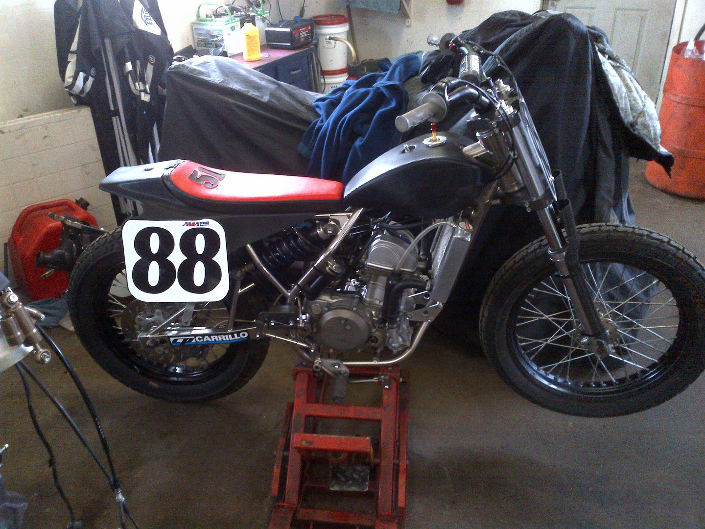

One of my brother in laws race bikes (flat track). This is a custom 450 Honda, the other is a custom 750 Kawasaki
