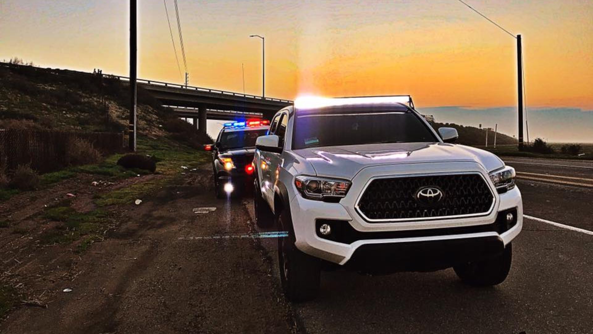

"According to the CHP’s Buttonwillow office, which posted the tale to Facebook, an officer stopped the egregiously law-breaking Toyota Tacoma driver bright and early Saturday morning for having an off-road light bar, which as you can see, is accurate. Likely to the chagrin of the aforementioned owner, CHP’s post cheekily reads, “We hope everyone’s 2020 is as bright as this guys off-road LED light bar. However, all off-road lights must be covered while the vehicle is driven on a maintained roadway.”"

Had some goof ball on I80 in the Bay Area with his very large roof LED bar on. He passed me it was noon and I could see him approaching over a mile away. About a mile after he passed me he was stopped with three CHP cruisers behind him. Going to guess he got a book of fix it tickets handed to him after getting pretty much every inspection step performed.
Legally such lights must be covered when on legal roadways. You wont get stopped for missing covers but the officer I’m sure will write a fix it ticket if your a Di-ck and he wants to stick it too you.
