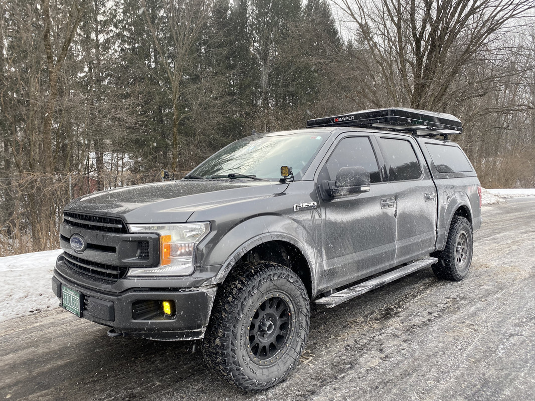

Flashback to pre-covid December 2019, I picked up this 2019 Ford F-150 XLT, 5.0 4x4 brand new. I had an identical truck, but a 2015 and loved it.
I quickly ditched the stock wheel and tire set up. I went with some 295/70/18 Nitto Ridge Grapplers wrapping a set of 18x9 0 offset ProComp Series 41.
Did it ever rub, I installed a 2 inch puck style spacer as soon as I got home. While the puck did it’s intended purpose by increasing front ride height, it rode terribly. I complained to myself every time I drove the truck.
I added a few minor things to “buy some time” before I could actually nail down some things that are later added. I added a basic tri-fold tonneau cover. It did it’s job, kept gear somewhat “safe.”
The Cap.
I found one, just a state away. The world was just awakening from COVID’s lockdown. There was no new caps anywhere to be found, except this one. J7 Magnetic gray, frameless rear window and yes I desired the solid side windows. I was pumped and hopped in the truck.
A short time later, after countless hours of debate and researching I settled on a set of Bilstein 6112 coilovers in the front with the 5160 shocks in the rear. Boy, I was “shocked.” They ride amazing and soak up incredibly. I sourced them from a few sales and promos, I think I’m right about $700 into them.
The truck was set up “well enough” for my current state. Held all the ski and bike gear I own. Took us on many trips and had some great lot camping nights. I added a few minor things along the way, mostly Diode Dynamic lighting.
When I hit the 30k mile mark I refreshed the rubber and wheels to a set of 295/70r18 Mickey Thompson Baja Boss A/T tires on Method NV 305 18x9 0 offset wheels. The same specs as my original set up. I’m blown away at the epic performance of these tires!

I got the Forscan software and the OBD link tool and did a bunch of “upgrades”
Most importantly Bambi mode, which is running fog lights while having hi beams on is great pared with the SS3 fogs. If anyone is on the fence I can walk you through it, it’s super simple once you get into the program.
I’m running halogen high beam bulbs as they produce more heat to help keep the lenses clear of ice and condensation. I am running an LED low beam bulb and really like the set up.
Added another set of ditch lights, SS1 series for more true ditch illumination.
I put in 4 ratcheting cargo load bars in an upright fashion to give more stability and support in the cap. While it’s rated for the load, taking any extra weight should help due to off-road abuse. Not to mention the ability to make a “clothes” line to hang packs and dry out clothes from bar to bar.
