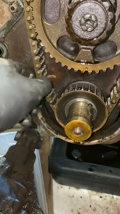

I figured I'd check for slack in the timing chain. I set the engine to TDC, pulled the cap, marked the rotor position, and turned the crank the opposite direction. I found that the crank would move about 13 degrees before the distributor rotor would move. The drive gear on the distributor was in good shape, so I figured I might as well pull the timing cover and inspect the timing chain.
This is what I found...
