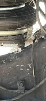

By the way, there are differential air vent plugs in various sizes. The one that comes as standard on the 2023 Fuso is too long and touches the base of the air suspension.
