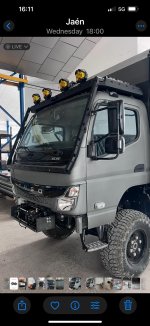

We are also going to paint the cabin (seeing the result, which is not too bad, perhaps with the same paint). At first, we had the idea of painting it professionally with conventional matte paint for an aesthetic finish, and also because it is less exposed to scratches than the box, but it has not turned out so badly and the paint is scratch-resistant. I don't think it will last forever, but let's hope it lasts.
Man I get so much pinstriping and can’t imagine doing anything that cost more that $29.99. Ok Maybe a wrap so I can take it off every couple years.
We used this scratch-resistant textured paint, let's see how it turns out. There are other brands on the market. Another one is Raptor, but it didn't offer the range of colors we liked.
It's not cheap, at 49 euros a can.
Not that it matters now, but Raptor is available in a tintable form, so it can be any colour you can imagine.
metallic, pearlescent, etc. is impossible with Raptor at least here in Spain, this color is based on this Mercedes color, what happens is that this paint changes with the light
