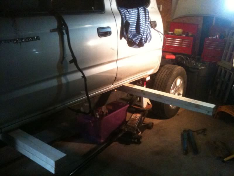

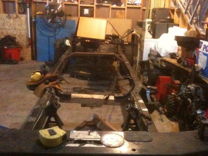

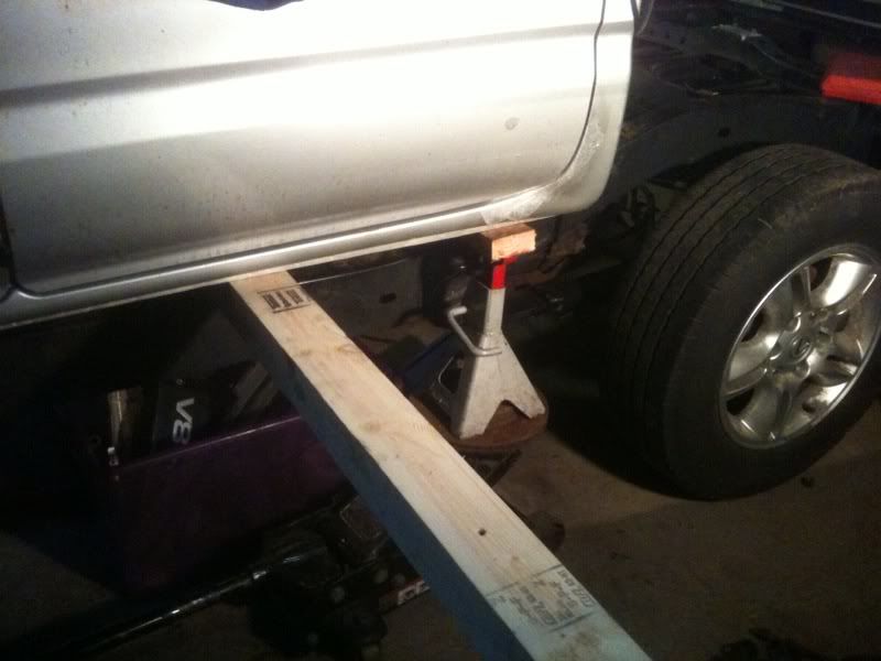

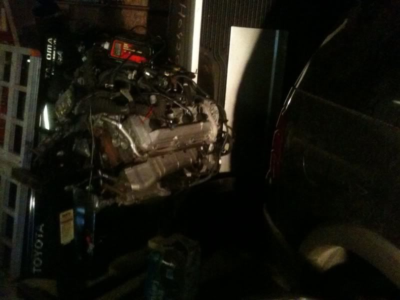

Time for a redo, v8 swap sold. Sorry for the bad pics this was a one man job so no time for good pics and cell phone camera only.
Pulling cab off frame.
My new 06 4.7v8
Frame extended by 14inches.
