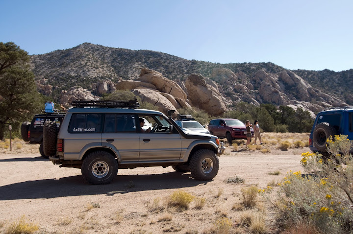

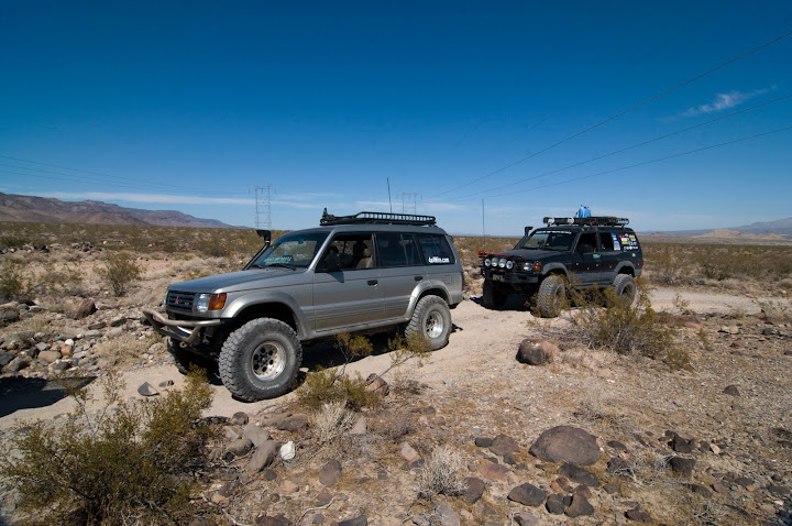

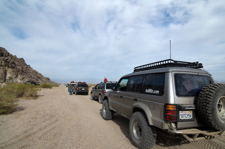

My latest mitsu build-up...
More mod's on the way...
Things on the table currently include...
1) Installing the rockskids (AKA rocker panel armor)
2) Modifying my bumper and installing the Milemarker SEC-12000 winch.
3) Installing these (sorry in advance for the porn below).:Wow1::Wow1:
A buddy found a set at a local pick and pull. I refurbishing them today with my friend Mike's help.
