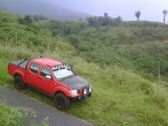

my navara dcab (built up)
no more AT for now.. get the MTs..
try different stuff..
Hankook 285/75/16
changing the BFG at 295/75/16
BFG i like the height but not the thread..
so here we go with month of may mods..
install them right away and do all the alignment needs..
see them BFG.. is out and here comes the mts.
thinking of winch at the back of the car.. looking for some bumper.. but here it is..
month of june mods
Agust and september mods..
changing almost everything that i can think of..
front bumper change look, lightforce 240 xgt change to lightforce 240 hid, add 2 140 lightforce with wide filter
side bumper (just paint)
rear bumper (no more winch)
top lightbar (better construction)
roll bar with 2 140 lightforce with dispersion filter
metal sheet 3mm sportlid
skid plate from the front to the back 3mm steel
still abit more to go :)

I love the rear winch bumper. Why did you remove the winch?
Are both bumpers custom made?
i like it too but the bumper is hangging too low because of the winch plate.. so i guess i chage them again..
they all custom made man
Your navara is really looking good... although I kinda liked it better in red cause it reminded me of my truck a little:ylsmoke:
