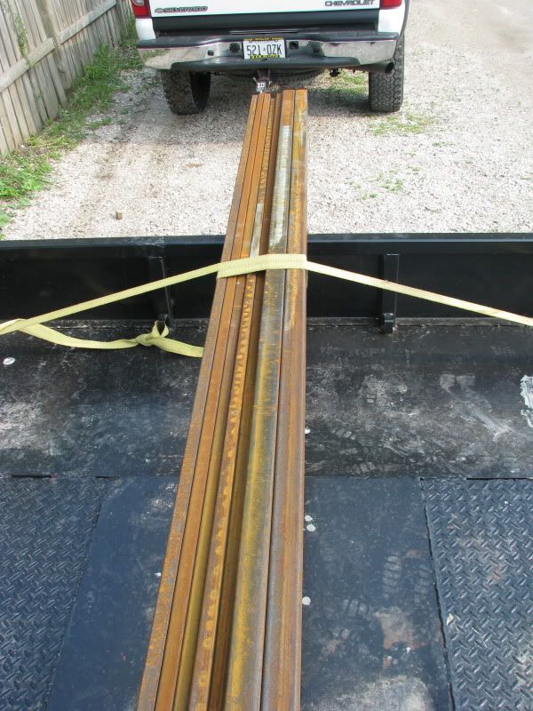

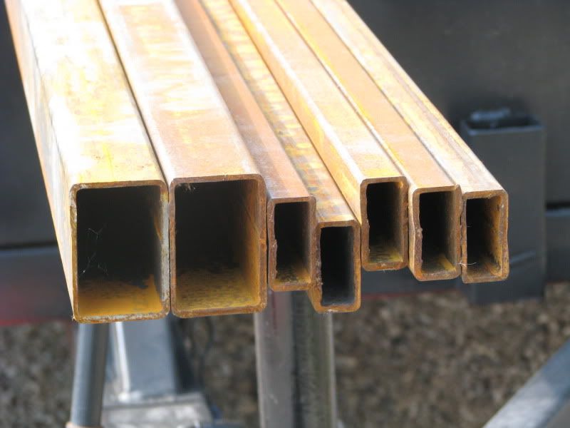

He did send me some pics of the steel he bought. :D
