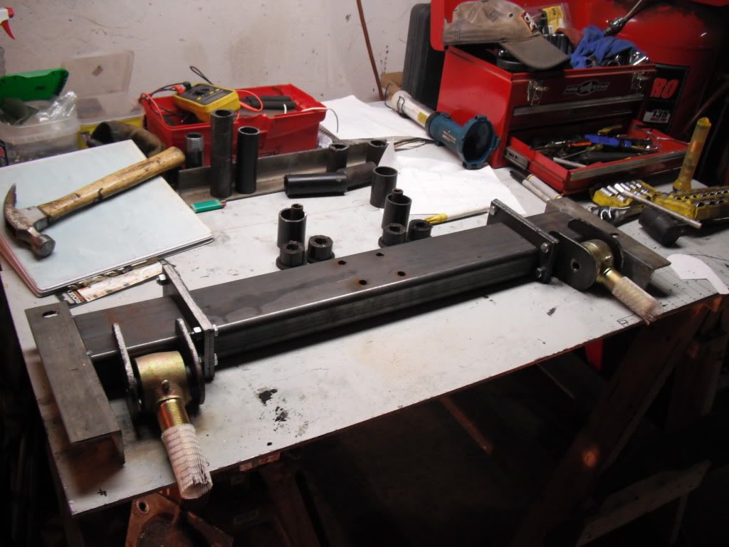

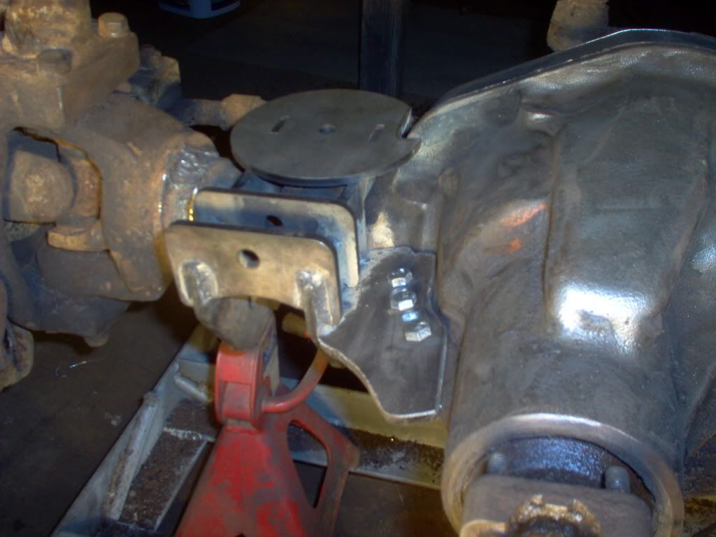

i'm actually building a Jeep truck for my wife as well with D60's just as a wheeling/plowing/hauling around the property kinda thing. I'm using 4.5" coils on this one. Here are a few pics. I make all the parts myself, I have a welder, a plasma cutter, drill press, grinders, all kinds of tools. The rear axle is a plain old D60, the front is a high pinion kingpin dana 60 from an 88 F350.
