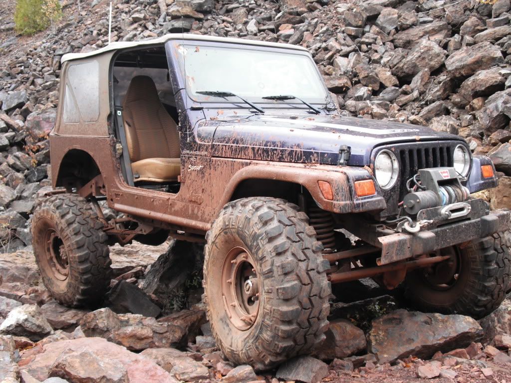

If you want to see more pics check out some of my albums here, lotsa pics: http://s94.photobucket.com/albums/l98/cocco78/
Here is my Jeep with the 38" swampers on it, its a trailer queen with these things tho. They don't go down the road well at all past 40mph!
My Jeep handles just fine at highway speeds, I would drive it anywhere anytime. It does not drive like a stock Jeep tho! Its got a bit more body roll around corners, again a trade off for off road performance. I run 37x13.50r17 toyo's on H2 rims, the rim with the most weights on it has around 2.5oz. They roll perfect down the highway. I also run Rubicon Express 3.5" coil springs and Bilstien shocks. I would stay away from rough country, there springs are junk, hard riding, poor quality. They are pretty much the bottom of the line, cheapest stuff you can buy. This is an area you don't want to skimp on, money spent here is money well spent. You also should go with long arms, its the only way to go to get a decent ride and flex...
Check out: http://www.claytonoffroad.com/index.php
Oh and I wouldn't go with a huge lift either, go with the lower springs because you'll be swapping to physically larger axles so that adds a bit of lift as well. Keep you COG low for best handling, trim your fenders to make them fit....
People are always amazed at how well my Jeep drives for what it is. But then again I have a scary amount of money it the thing! Its not the perfect setup really for any 1 thing, but it works. I'm not sure why everyone thinks its going to be so terrible on gas, I get better mileage with this thing than most of the other people I wheel with. My dead stock gmc sierra may get 18 or 19 on the highway but will get stuck on wet grass, and only get 12-14 around town or cruising back roads. My Jeep will do 14-15 on the highway and 13 or so in town and in the woods. Just filled it up today and got 13.5 with about half the miles on 2 lane county roads and half in town.
I'm not defending the original poster tho, your young and have alot to learn even if you think you know what your doing. Go have fun build your Jeep and learn from your mistakes, you will learn alot of what not to do during your build. There is nothing saying you can't change it later on. I know my next Jeep is not going to be built anywhere near the level my current one is, i'm thinking 32's max...
