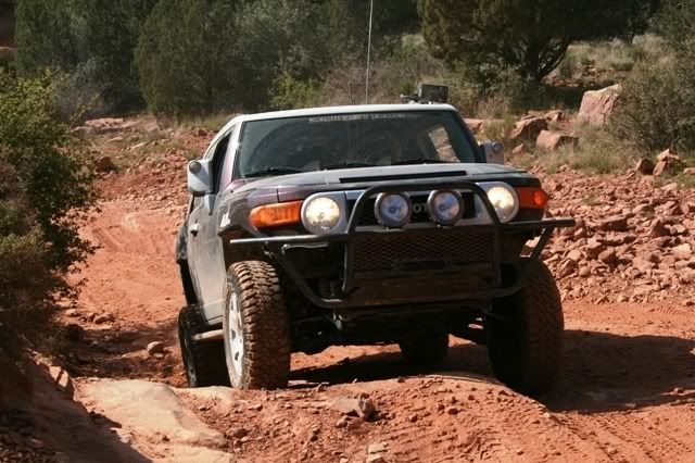

Just a quick report, but they work great!
They actually completely eclipse the light output of my normal highbeams to the point where all I can see is the white light everywhere. It looks like my highbeems aren't even on.
So far so good. The beam shook offroad, but until they are mounted on a tube or similar bumper I will attribute that to being mounted on my flimsy stock steel bumper. :safari-rig: :sombrero:

I have a super stout Rokmen front bumper. Driving down a super washboard dirt road will produce minimal bounce. Small enough that I'm not sure if it is the bumper/light or just the jiggling of the whole jeep.
