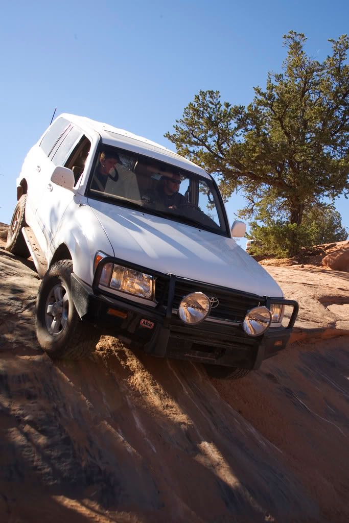

This picture does offer the best example in a photograph, that I can offer.
Look at the trees. Now you see'em, now you don't. That is the biggest thing I notice. A bigger view of objects at the 1/4 to 1/2 mile range. They add to the field of view probably 20% as well.
