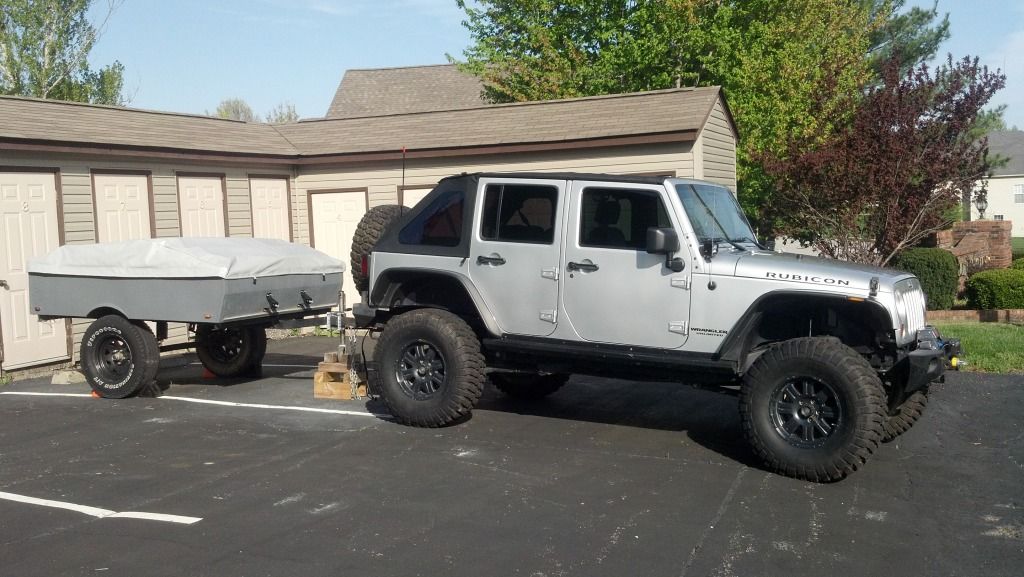

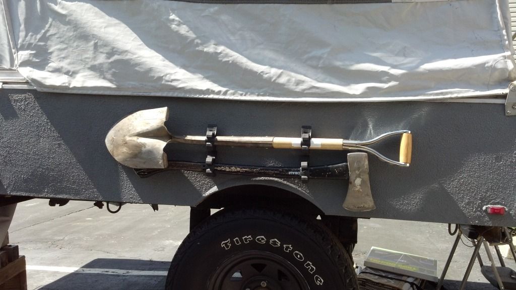

Sorry I have not had a chance to measure the WMS distance on the axle, but here's some pics of it behind the new rig. BTW, Thom, im interested to see how yours turns out!
http://i1189.photobucket.com/albums/z439/jetnoise/1333672972.jpg
http://i1189.photobucket.com/albums/z439/jetnoise/1333672994.jpg
http://i1189.photobucket.com/albums/z439/jetnoise/1333673015.jpg
http://i1189.photobucket.com/albums/z439/jetnoise/1333673036.jpg
