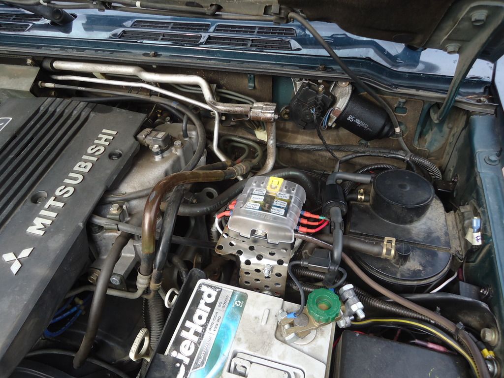

Ok, after all these additions with relays, I needed to add a supplemental Blue Sea fuse box, but mounting issues in the engine bay were limited so I ended up making a mounting bracket and bolting it to the battery tray.
