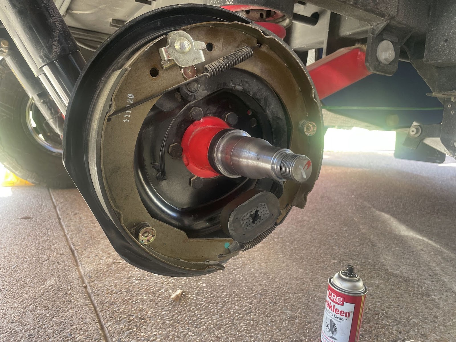

After a year and change, I serviced the wheel bearings and adjusted the brakes on my Dweller 13. Given the overseas manufacturing and the lack of any details from OBI, I was not sure what was going to be required for grease seals and bearings (if needed).
Inspection and measurement confirmed the brakes and hubs are Dexter-style 12” x 2” drums. Further inspection confirmed that all the service parts are exactly the same as the equivalent Dexter 6000 lb hub and brake assembly.
  • Grease Seal: 3.376” OD, 2.250” ID, Spring-loaded Double Lip. Dexter p/n: 010-036-00
  • Cotter Pin: 5/32” x 2”
  • Outer Race: p/n 15245, 2.441” OD
  • Outer Bearing: p/n 15123, 1.250” I.D.
  • Inner Race: p/n 25520, 3.265” OD
  • Inner Bearing: p/n 25580, 1.750” ID
  • Dust Cap: 2.44” OD
I was also happy to find that everything was in good shape. I have pulled my Dweller about 7K-8K miles. The brake shoes had the expected wear with no signs of dragging on either side. The bearing and hub cavity were “fully packed” with a bright blue grease. There was no sign of water intrusion and the bearings were in excellent shape.
Given that I did not know the specifics of the grease type, I went through the tedious process of fully de-greasing the bearings and hub cavity. I repacked the bearings with Lucas Red-N-Tacky, replaced the seals, and reinstalled with fresh cotter pins.
Servicing the bearings is a messy job but very straightforward to do with no special tools required ( I find a curved claw hammer as the perfect tool for removing grease seals). Be sure to adjust the brakes as well while you are at it. You can use a large screwdriver to turn the adjuster star wheel, but I think it is worth it to buy a nice brake adjusting spoon. If you have not done this before, Dexter has some very good videos covering both procedures.
