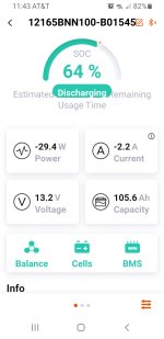

Update on Lithium charging.
Due to my poor knowledge I was able to get on the Litime app and finally figured out to click the icon to activate the bluetooth on battery 2 & 3. They are now on 100%. However, number 1 is down to 64% and is discharging with power & inverter on. Nothing is on and drawing any energy except the inverter. Is all this normal? The inverter shows 120V in and 119V output. I was trying to get all 3 batteries to 100% per most of what I've read. Can anyone shed any light on this?

I’m 99% sure what you are seeing both in the charge and the discharge is normal with multiple batteries hooked up to one circuit. Somewhere in this thread, another person had the same issue when they called the manufacturer the manufacturer said that’s the cascading stage of how the batteries charge themselves. I don’t remember the specifics. I don’t remember the manufacturer but it’s in this thread somewhere I know that’s not super helpful. It’s 130 pages. But yes, it will charge the battery to 100 and then cascade or waterfall charged to the next and then the next.. discharging it does the same thing just in reverse it pulls from in your case the first battery then it will pull the second then pull the third. Now in that post that I referred to earlier, there was a discussion on how the internal clock on the batteries figure that out. It is not going to charge the first battery zero and then charge the battery is not gonna do that. It discharges, the first has a kick where it then will shift the second bring a second down then the third and then cycle back through and whatever pre-program it has.
So if you’re measuring individual batteries and what I said above is true for your batteries yes, what you’re seeing is normal. You’re gonna have the first battery draw, but your average of the three is gonna be basically “full. And I wouldn’t expect to see the charger kick in until the average of the three hits your charge point voltage whatever you have that set up For.

I've got 3 - 140AH's hooked up in parallel, sometimes 1 battery will discharge, while the other 2 "standby", other times they all 3 are being used. I've not figured out WHY, but eventually they all get brought back to 100%, so I guess all is well.
Here's an artical from another manufacturer that might help to understand what's going on with multiple lithium batteries in parallel: https://www.wattcycle.com/blogs/new...ersion-battery-take-turns-in-parallel-systems
