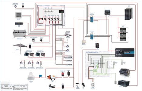

Yes, should definitely work on 12v battery power only. The A/C and 120v outlets are the only things that should be powered by the 120v side of the inverter.
Positive wire of the heater should go directly to the fused red main power switch and the negative wire goes through a breaker and then to a negative battery terminal(s), according to the wiring diagram.

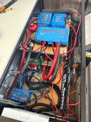

Victron Upgrade Complete!
So for the last three days I've been ripping the guts out of my Dweller D13 (all that sketchy Chinesium wiring etc) and replacing it with rock solid Victron equipment. The space was tight, but I got it all in there... and I am LOVING it ! Link to pics of the stages of the install are HERE if anyone is interested.
there's a wiring diagram???
