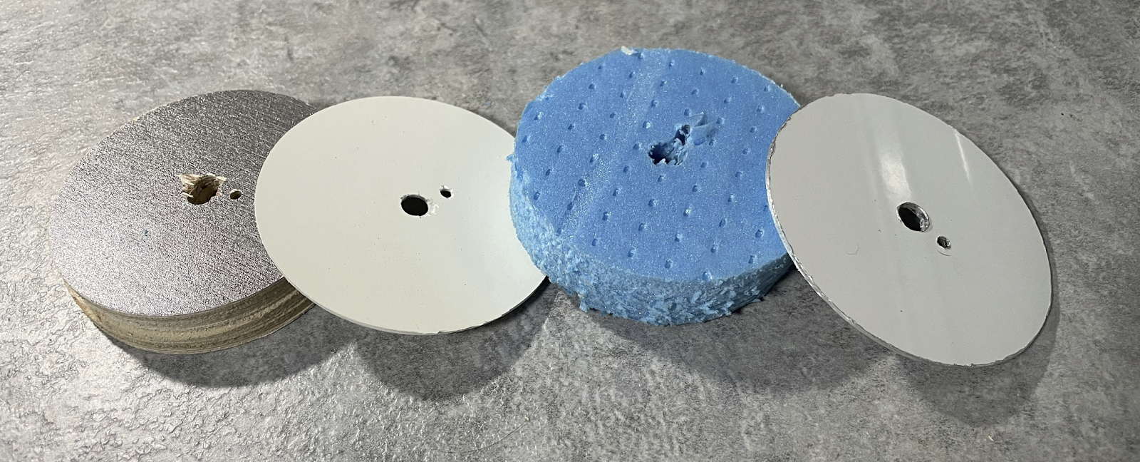

If anyone is curious about the wall construction on a Dweller, here is a core sample from the front wall of my D13.
From right to left:
  • Outer Skin is aluminum. It measures 0.063” which is a bit thicker than 16 gauge.
  • Core is some type of blue foam that measured about 0.890”
  • Inner Skin is some type of glass reinforced plastic (GRP). Pretty stiff stuff. About 16 gauge as well. I measured at 0.056’
  • The plywood is not part of the wall structure but it is behind the front vertical wall. It is a nice 9-ply material about 0.575” thick. I think the same plywood is used on all of the cabinetry.
From right to left:
