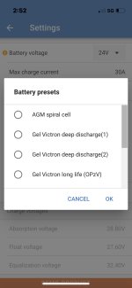

I just installed the victron mppt 100/30 charge controller. Victron seems to make the smallest charge controllers. I am still confused with the battery stuff. What battery presets setting would u think i should use with the stock agm batteries ? I just ordered the li time 100ah lifepo4 on amazon today. but in the meantime I would like to have the correct settings. I am not a big fan of the blue tooth stuff, I would prefer to not take my phone with my while out camping. I will admit it is kinda nice though.

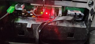

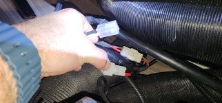

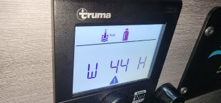

So I have not been able to get the hot water to work since we have bought the camper in June. We have a trip planned in a couple of weeks and will need it since it will finally get cooler down here in the south.
So I opened everything up and discoverd one of the wires came out of it's crimp. This was the red wire of the connector I am holding with my thumb in the first picture. After trying to electrocute myself 4 times trying to figure out how to shut off the power completely on the camper, I finally just disconnected all batteries to work on it. I connected black to black and white to red and then when I attempted to connect the batteries again. It arched... So I switched the wires and that seemed to be the answer to not catch the whole thing on fire. After getting it all back together, I started getting the W44H code which means "# 44 Undervoltage, battery voltage too low < 10.0 V". However, the battery was showing 12.7 v at the time. The water was on, pump on, propane on, etc.
Anyone have further ideas?

Are these wires pretty easy to get to? I could check my configuration this weekend and measure voltage for you.

You have a preset function for AGM charging (top selection in your photo). The three phases of AGM charging are pretty standard (bulk, absorb, float), so that selection should do it for you. It will also have an equalization function. If you return your AGM batteries back to 100% every two to three weeks (or more often than that), there's no need to use the equalization function. You're going to really like the lithium batteries as an AGM replacement. They say AGMs can be drawn down to 50%, but if you want to take care of them for the long term, don't go below 70% on a regular basis.
Yes, it is directly under the bed. I had to open up thr entire back end to have enough space to remove the panel and gain access to the truma and water pump though.
