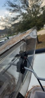

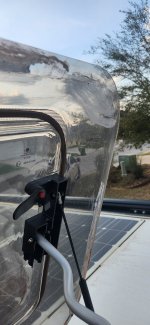

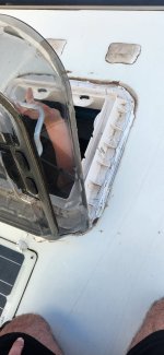

Bought my Dweller from Fun Town RV in Giddings, Texas in the summer of 2022. I loved it the day I bought it. I still love it today. It isn't perfect. But no trailer is. I knew that, I'm cool with it. Got the standard 1 year warranty. Skylight opened and functioned as designed. Winter of 2022/2023, our seasonal rain returned. Like so many others, my skylight over the bed leaked a little bit. No big deal, really.
May of 2023, schedule an appointment for warranty work. Take a day off work. Tell them I can not leave my trailer overnight. Need the batteries tested, jack replaced and the water leak on the roof identified. Drop it off at 8am, and stay in town. Fast forward to 6pm of that same day, and it's ready for me to pickup. Most concerns moderately addressed (long story), but they said they couldn't identify a water leak. Cool, that's odd. But whatever.
Interestingly enough, post warranty appointment, my camper never ever leaked rain in, ever again. Not once. Even in very hard downpours. Guess it fixed itself? Lol, more on that.
Several times between May of 2023 and March of 2024, I'd attempted to open my skylight, but couldn't. I didn't think much of it, because I didn't care a lot. It was getting deleted for an A/C unit anyways, so it didn't matter. I only tried to open it a few times to air out the trailer in the driveway.
March of 2024 (last night, actually). I go to remove the skylight to get a cross section of the roof and design for my Air Conditioner adapter. Guess what I found....
The idiots at Fun Town RV sealed my skylight shut. No, I'm not kidding. See pictures below. Guess this explains both why I couldn't open it, AND why it never leaked.

I bought my 13' from Fun town in Giddings in July '23. They are clueless. I'm curious to see how your A/C install goes. Please share your approach!

Consider yourself lucky. It looks like they missed a couple of spots. :)

Fun Town RV: Where any Winnebago can be a Submarine with enough caulk.
Feel free to DM or find me on Facebook. I also have a D13 with lots of mods. Might can save you some heartache.
