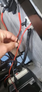

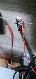

Helpppp!! When checking under the bed I noticed a loose wire... not sure if it fell out of the little white connection box since I only see a red wire going into it.. anyone know if there is a red wire and black wire that should be going into that white box thingy?
