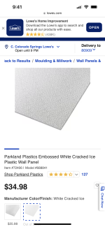

Made a run to Lowe’s and grabbed the interior wall panels, so those will be going in soon as well as painting and staining selected areas (headboard, bench, bed and cubbies, maybe the V-nose wall).

We considered keeping the wood walls, but my finish on them wasn’t ideal for that and with such a dark ceiling, we know we need light colored walls to avoid a dark basement feel in the trailer. I almost just opted to paint them a nice off white, but the wife wanted something a little nicer so we went with some 0.090” thick plastic panels from Lowes. They have a little texture pattern to them, are pretty lightweight and should make a nice clean finish. Though I do remember when they were under $20 a panel and they’ve now almost doubled in price.
