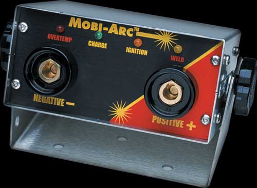

I have been around 2 premeir welders and one mobi arc
The first time using a premeir welder was in Tellico. After a bit of welding we had an optima battery over heat in the Defender and it rendered the welder useless. I guess there was a problem in the circuits. My next experience was with a premier welder on our baja trip. We had installed the unit and tested it before we left. Unfortunetly when we needed it after having a massive trailer tongue issue, the unit was dead. Fortunetly Chris from Campa had a Mobiarc unit on his TJ. It worked like a charm.
I have learned that the mobi arc system has a mig option however you can only mig on somehting other then your truck with it. If you need to repair your own rig then you have to stick weld it. There are several options with the setup depending on what type of welding you want to do and how big your alternator is. so I would consult with mobiarc on which unit is best for you.
