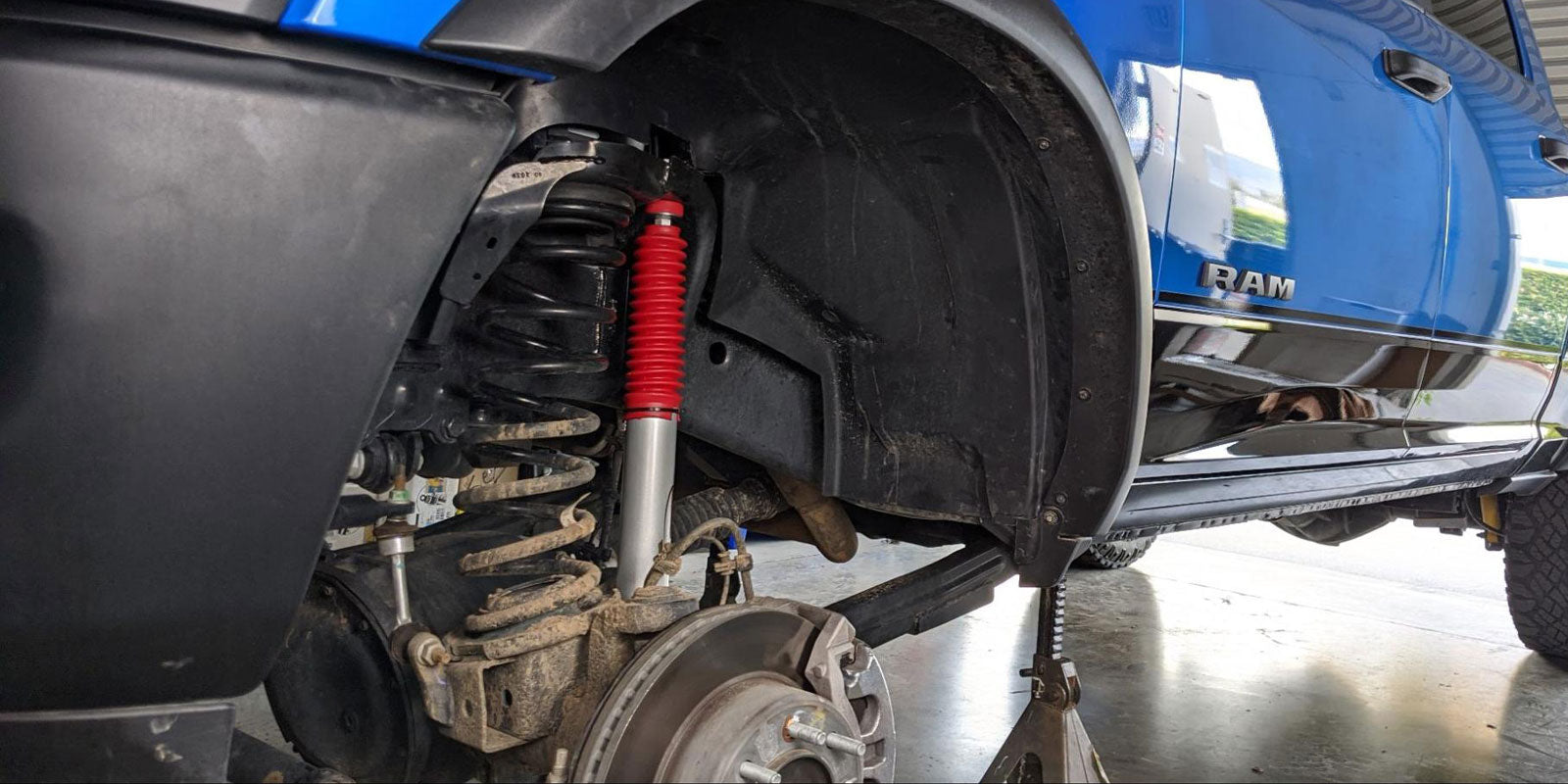

I ran across this review of Rancho 9000 shocks on a Power Wagon. It's a good intro into what varying the shock damping does to the ride and handling both on road and off.

The OP has a 1 ton with a 3k lb load max. And that pickup in the link isn't exactly empty, being loaded for camping. Not that it matters; the effect of damping changes will be the same in any case.
