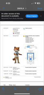

Hey guys I noticed by the upper corner of the windshield there was clear sealant and rust forming where the water channel meets the roof. And when I arrived, I saw the owner take a can of R134-A. I asked him how the air conditioner works and he said perfect. Then he told me that he has driven this car all of the world and he has put a lot of money into it.
I did a carfax and it shows that he bought it from an auction as a flip. Which honestly I don't care, everyone needs to make money. But, I just didn't like the dishonesty.

Do you think is an issue?
Hard to see with the weather striping in the way, but judging from the picture, I am not sure if it's gonna look any better under the weather stripe. To completely fix the rust around windshield, you have to take it out, and require decent amount of work of cutting off old pieces and put in new metal. Check ih8mud for that.
