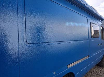

A few notes on using the Majic (tractor supply) equipment enamel. Catalyst/hardener is required if you want any real durability. You must wear a fresh air respirator, or a high quality full face organic vapor mask (with fresh cartridges). Painting outdoors is less sensitive, but indoors wear a full body coverall from a vapor blocking material. Secure it tightly around the gloves and neck. Isocyanates (hardener) are nasty.
The ratio i used was 8:4:1 Paint:reducer:hardener. I used naptha, and my temps were around 60-70F. I got some full sun on the front, and it cured pretty fast for the type of paint it is. In colder weather, or maybe indoors on smaller projects, acetone will work as a reducer. In hot weather I would use mineral spirits. But evaluate the relative humidity as well. I used double the hardener they call for as folks suggested it after talking with tech support. The suggestions they give need to meet the VOC requirements in various states, so you can get better results in some cases by not following them. I used double the hardener, and much more reducer/thinner than suggested.
Power mix a minimum of 5 minutes to ensure no separation in the can. Once you add the hardener, the pot life is about 8 hours at 75F, put it in the fridge to get another 4-6 hours.
I did all my mixing in 1 liter batches. The handheld self powered sprayer I used was a 65$ one from Amazon, and it worked just fine for what it was. I selected the 1.5mm tip, but you could go larger or smaller depending on how you thinned the paint. My DIN cup test was about 35 seconds at the ratio above.
I added the paint to the mixing cup first (you can use a ladle to keep things clean). Then I measured the hardener, and rinsed my measuring cup with the required amount of reducer/thinner.
I used a drill mounted power mixer for at least 90 seconds. Hold the container to prevent the drill from spinning it, as the paint is thick.
Filter all the paint through a fresh strainer into the gun. For each batch do a quick test on a fresh piece of hardboard, or other smooth/flat surface. Use a wet film gauge to ensure your film is matching the specs. About 0.002 (2 mil, not to be confused with millimeter). You can go thicker, but dry time will be impacted. Once you confirm good thickness, go ahead and spray. It went on pretty quick, and with decent technique coverage is good. I was able to get by with 1 medium-heavy coat, except a few touch up spots. It helps that my existing paint was a fairly good match color wise.
In direct sun the paint was tack free in about 2 hours give or take. In the shade it took a bit longer. It will still show fingernail marks at that point. But once it starts to go tack free you can do another coat if you are using hardener. But beware of wrinkling if you want a smooth finish. Better to wait overnight to recoat if you need a high quality finish.
This paint is brushable. So I will go back, sand a few runs, and then catalyze and apply via roll/tip to the areas that need it. Door jambs etc. Down the line if the next owner needs to do touchups, they can just buy a quart of paint, and do the same.
Still curing, but good enough to put the windows back in. I have never seen the van this shiny... The gloss is pretty high, but should fade over a couple of weeks somewhat.
So I am curious how you got the texture from a paint that should normally be smooth? I didn't think that Majic was a "Raptor Liner" type texture. Loving the color. Nice job.
This van was Monstaliner (urethane bedliner) coated about 10 years ago. I later discovered that the factory primer was not properly applied in a few areas, and I have been fighting minor delaminations for years. I would prime and touch up, but finding a match for the monstaliner, which faded with time, was difficult. Hence why recoating the whole van with something that would allow for easy touch ups was a goal. Since the enamel was a close color match, I faded it into the existing liner at the jambs, and it blended pretty well.
Ah, that makes total sense. Thanks for that info.
