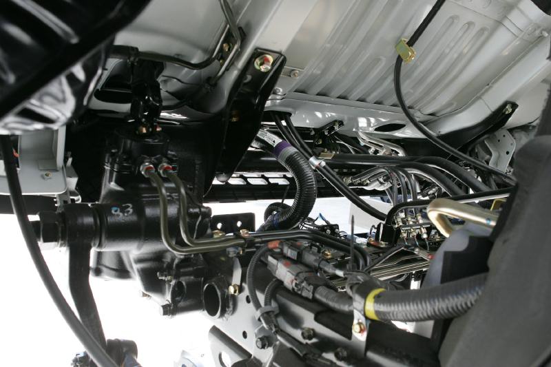

This is our cab hinge area on our U.S./Canada 2007 model year LHD FG. The wiring harness is the large black tube that looks like flex radiator hose.
It is located on the driver's side (LHD) frame rail. If the RHD wiring harness is located in the same position, then swapping the driving position from RHD to LHD would be very straightforward, just a matter of swapping in a dash and some steering gear components.
If you were working with another truck and the wiring harness was centered on both LHD and RHD, then there would probably be enough slack to reach the cab terminations for either configuration.

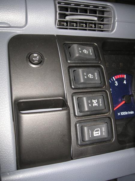

I had a good look at the LHD SWB work body on ebay. Our 4x4 shift is where the old gear stick used to be but I couldn't see it on the SWB. Is that the big lever on the left of the steering wheel???
On our current generation FGs, the 2wd/4x4 switch is on the dash. It's a rocker switch with a 4x4 chassis graphic. The big lever on the left end of the dash is the low/high range selector for 4x4.
Photo of the 2wd/4wd switch. I moved all the switches around on our truck, so this may not be the stock location.
Switches are, top to bottom: fast engine warmup (stock), fuel filter heater (non-stock, added as part of dual fuel filter array), 4x2/4x4 switch, door locks.
The seat heater switch is non-stock. I added that with the air seats.
