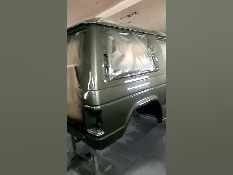

Body painting
The body was painted in the original color. The sills and side moldings have been additionally protected with RAPTOR paint in body color.

IMG_20211202_221722_1.jpgIMG_20211202_221740_5.jpgIMG-20211202-WA0023.jpgIMG-20211202-WA0024.jpgIMG-20211202-WA0017.jpgIMG_20211214_210427_5.jpgIMG_20211214_210355_1.jpgIMG_20211214_210401_7.jpg
