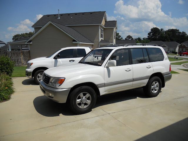

...Next project: Mount 50 inch LED light bar in a manner that preserves the roof rack as the highest point on the vehicle. Any ideas on how to go about this?..
A 50" LED light that still leaves the rack as the highest point?.. I believe Rigid Industries SR Series (single row of LEDs) are 1-5/8" overall height, 3" overall depth, and they have a 50" model - http://www.rigidindustries.com/product-p/srseries50.htm
Maybe you have enough clearance to fit one under the leading edge of the rack?.. The included brackets look like they're made to mount the light above or below the mounting surface. If not then it shouldn't be too hard to find some deeper brackets to bolt it to the facing end of your rack (the literature says the light weighs 8.3lbs), but I'm not sure how secure a mounting configuration that would be or how much 'bounce' you might see in the beam at night offroad.

The wait for the roof rack is over! Yesterday, my Front Runner Slimline Wind Cheetah 2.2m aluminum roof rack arrived.
I'm sure you'll enjoy this roof rack. I've owned one for one year now and it's moved from the 80 to the 100. Looks good.

It takes a little to dial in but you know it is worth the effort because its a quality piece. I've had it apart 5 or 6 times trying to fab a vibration-free light bar mounting bracket. Wind noise can also be an issue. I always think of the noise implications with every tweak I make on it.

8.3 lbs? For the single or dual row 50? Mine weighs 25 lbs easily. I think I figured out how to get a vibration-free bracket put together without having to buy a plasma cutter and/or a welder! Also, I mocked up some brackets in cardboard that should drop the whole bar about 1.5" and bring it forward 1/4-1/2". We'll see...
