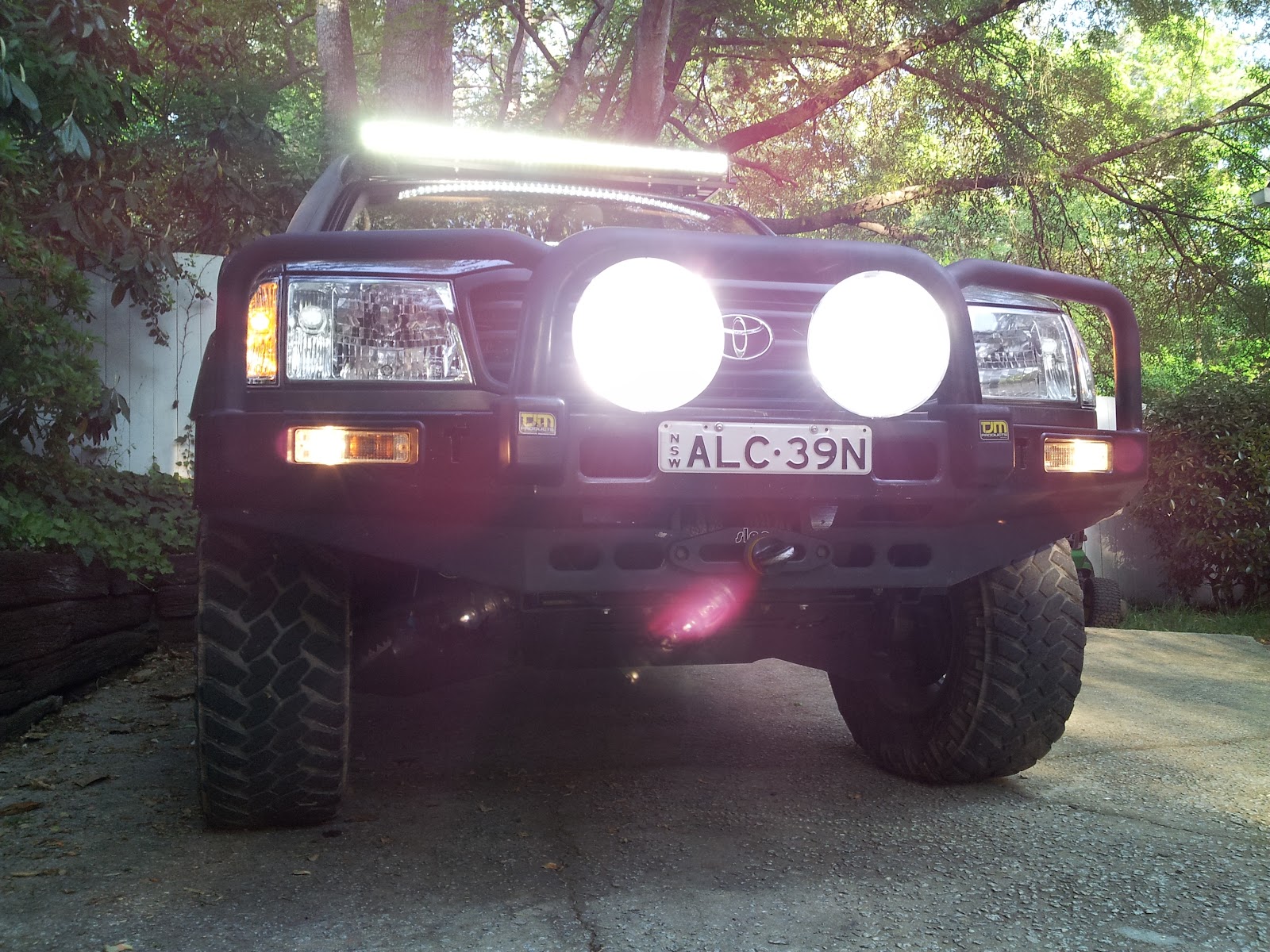

I finally found the time to hook up my Lightforce Blitz 240s and fab V3.0 of the 50' LED light bar bracket. Not sure if I mentioned it earlier but I found an Australian thread a while back where this guy was converting 240s to HID. I really liked the idea as the LF lens and reflector are a perfect match for HID. What I did not like was the prices companies were charging for HID technology. I think the LF's in 35W HID were around $1000.00 at one point. I have a good connection in China for sourcing just about anything. We communicate very well and he knows what I expect when it comes to quality. I asked him to look around for the highest rated HID ballasts he could find. A week later, I open a package an lo and behold, there are two 100W HID ballasts staring at me! I gutted the LF 240s, retrofitted them with 6000K big bulge 100W bulbs (thinking now I should have gone with 5000K), ran the harness, bolted the ballasts to the brackets that secure the radiator and I was ready for some testing. 100W HID full setups like this aren't even on the market! New products are coming out at a rapid pace but I have yet to see a pair of spots that will give the franken-LFs a run for their money. I have a thread on the LFs is case anyone is interested:
http://forum.ih8mud.com/electronic-toys/517152-lightforce-blitz-240-100w-hid-conversion.html
So my plan is to use the LED light bar for tighter trails where I need a good field of view with a great deal of saturation. I replaced the combo lenses on the LF 240 100W HIDs with spot filters and will use those for when the trail opens up and I need the ability to see far ahead while at speed. I tested both setups at a place called River Rock in Milledgeville GA. The LED light bar was phenomenal. I was on a group ride with a group of rock crawlers and the route they chose was full of elevation changes, switch backs, washes, ditches, boulders and foliage. The LED light bar did a great job presenting the upcoming terrain/obstacles in a wide, clearly lit view. Quite a few people on the run had never seen a larger LED light bar and the feedback was very positive.

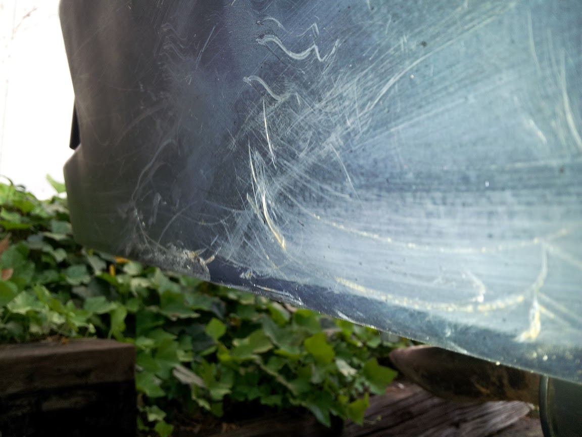

I didn't get any action shots from the weekend as it was dark and I was trying my best not to soil my drawers...
This was a seasoned hard-core group of rock crawlers riding around on a privately-owned rock crawler playground. The gentleman who built the area, incorporated by-passes around all of the hairy bits (read, 85% of every square inch of the property), but what he defined as a by-pass was near the limits of what a build 100 is capable of. I had a great time not blinking and clenching my butt cheeks for 6 hours!
Glad I had sliders!
And finally, here are the lights...
MY EYES!!... Lol, I'll bet that's bright as hell in person. BTW, the weight I quoted before was their spec for the single row model. Yours looks awesome up there!
I though that number seemed a little low. The lighting setup was very bright in the field. One thing to note was that the LED bar did not put out as much light as I thought it would. I had a 20 inch light bar just like it up front for a while and I thought the 50 would have blown it away. I guess it it sort of like horsepower, twice the horsepower does not mean twice as fast. Nothing negative towards the light bar, just an observation.
