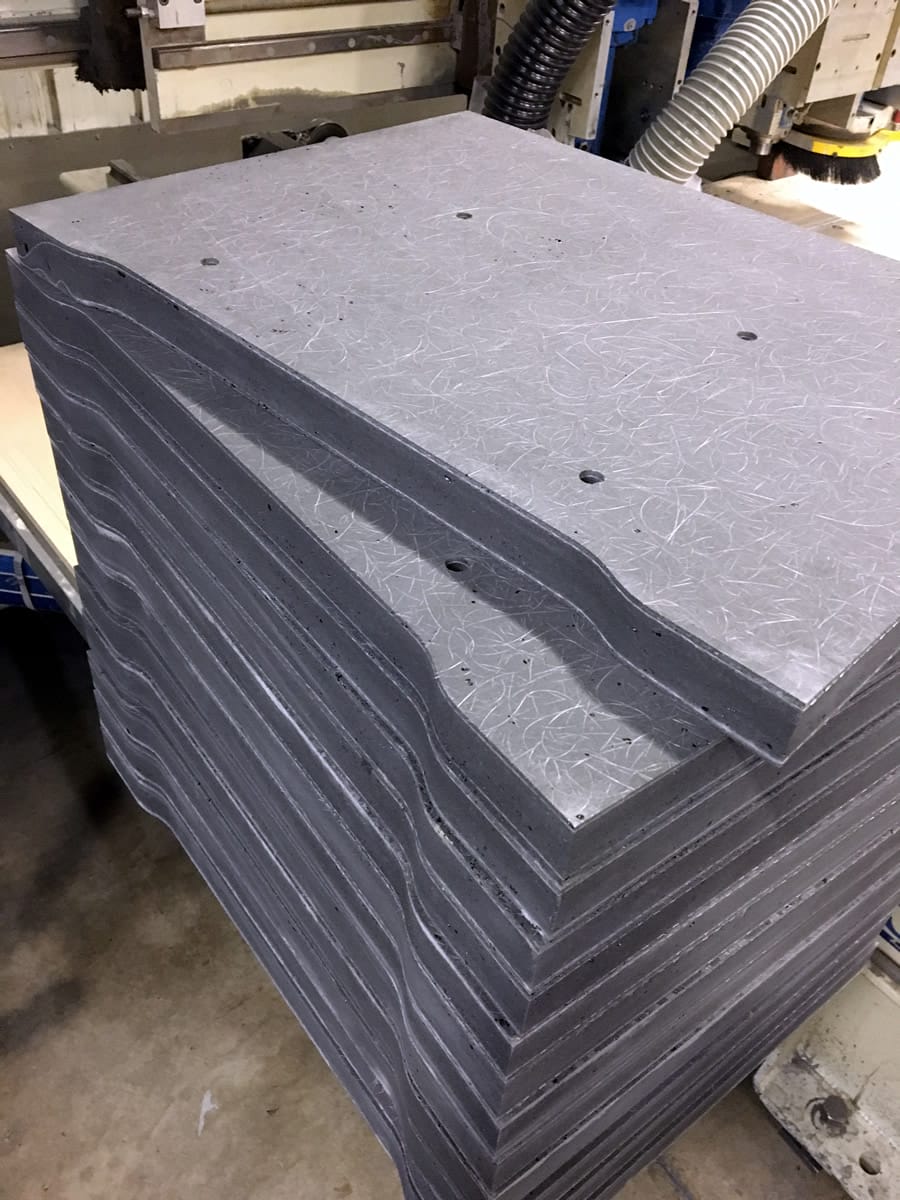

Little update,
received my panels for the box,
test fitting them in the garage,
removed tarp, structure and panels from Pinz
The idea is to test fit them on the Pinz,
then bring them back in the garage and glue them upside down like on the picture,
so ceiling on the floor,
glue the right side panel to ceiling
then glue left side panel to ceiling
then glue the back front panel to ceiling and side panels
Any feedback appreciated, especially on how best to glue them together.

For the floor I'm going to use Thermolite boards. They are very stiff and provide a reasonable insulation. They are lighter than wood and do not absorb any water. I will bolt them to the frame and bolt my equipment to them.

All 4 panels glued together, they weigh 116 kgs / 255 lbs
starting to glue L fiberglass profiles
using Sikaflex 252
short video here:
