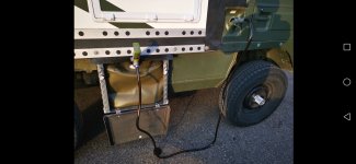

Last week I took my first real trip with my converted Pinz.
Everything went well! No problems with the Pinz.
I visited a forested area in northern Italy that was for sale and needed an off-road vehicle to get there. I asked the owner if I could stay overnight. It was a beautiful place, very quiet. I drove over the Simplon Pass in Switzerland, mostly going up in fourth gear, sometimes in fifth or third.
On the other side, I went down using engine braking, but with my fuel cut-off system activated, so no fuel consumption! Overall, I used 14 liters per 100 km, quite nice. 500 km round trip, and I didn't have to refuel during the entire trip because I used one of my fuel bladder, cool. Good engine temperature. Warm shower works well. I'm satisfied.
