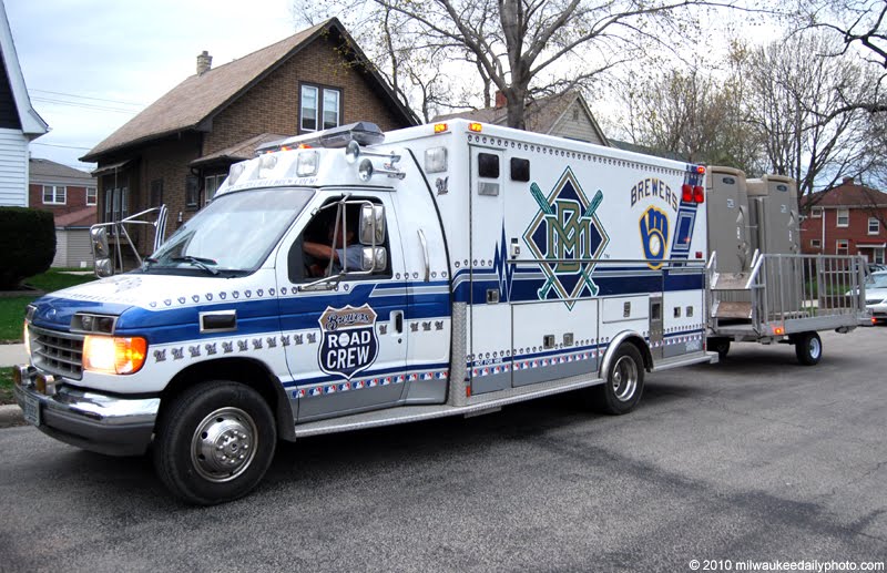

While researching new tail lights for mine, I came across these rigs. I guess we aren't the only ones who have found a use for surplus ambulances.
Disclaimer: I'm not a sports fan, so the names of the teams on the vehicles don't mean anything to me.
See the interiors: http://www.tailgatelot.com/content/tag/ambulance
...a converted ambulance, decked out as a full-blown tailgate extravaganza, complete with its own portable toilets on a trailer in tow.
http://milwaukeedailyphoto.com/2010_04_01_archive.html
The "Normbulance" is the man-mastery of Rob Dibble, '96 alum and corporate trainer at LPL Financial. He began outfitting the Normbulance with a full bar, flat screen television, beer fridge and custom paint job two years ago. Emblazoned with its own crest, the "Normbulance" touts "Honor, Loyalty and Passion" as its creed. I am positive the crowd tossing back the complimentary green jello shots from Dibble's truck were filled with just that.
