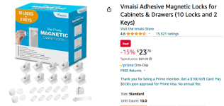

Great suggestions... wish I could see the links/photos? Nothing showing up for me?
Baby drawer locks are a great idea.
If you look at the post in a web view you should be able to see the link. If not, go to Amazon and search for Vmaisi Children Proof Cupboard Drawers Latches.
