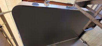

After many months off again... again... I started working on the camper again a couple of weeks ago. The frustration with the roof, losing my Dad, life... all needed time to deal with. Now, new energy and motivation to get this thing going.

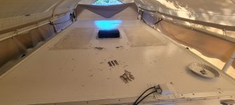

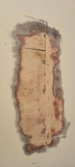

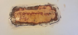

I took apart the roof, meaning I ground down the bubble, I removed all the solar panels and the cables etc and inspected the rest for failures. Nothing. Interestingly it seems that the luan came apart, no water damage so it looks like the glue failed in between the layers. Ooof.
Roof stripped (again)... dirty from dust and birds getting in the shed (I keep it open for airflow).
Here you can see the seam where the luan lifted the top layer. Might be from water, but if it was it sure didn't look like it.

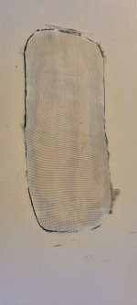

Cut a couple of layers of glass (cloth) and mixed up some polyester resin. Loaded up the cloth to fill all the fibers and it turned out great.
Glassed.
I sanded the entire roof and washed it 2 x to get it super clean. I then primed it with 2 coats of primer, 2 more over the glass... and then 3 coats of rubber roof coating for RV's. It is highly recommended and is flexible so with the right primer you can even put it over EPDM roofs. The edge of the roof is Eternabond, which I must say is an amazing product. That stuff sticks to everything and is nearly impossible to get off. Ask me how I know. lol

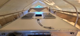

Roof now has all the solar re-mounted and the cables re-attached to the controller. Going to ditch the Renogy MPPT for a Victron unit. Picked one up NIB from FB Marketplace... I like the Renogy stuff, but the Victron is 1/4 the size and the BT is much better with a much better interface. Pics pending...

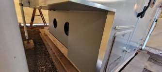

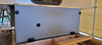

I also re-painted all the underside of the sides of the camper and 3rd coated the trim around the top of the tub to get as much protection on there as I can before I put the fabric on.
Tub repainted with 1 component water based epoxy.
Fresh...
Under the bed too.

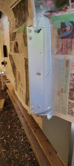

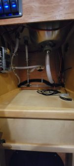

I took off the jacks and re-painted the steel brackets and cleaned them up. They were looking a bit worse for wear and needed a refresh. I also cleaned up the jacks too. They were used, and although they were fully re-built, they were not re-painted.
A while back I re-did the plumbing a bit and cleaned it up a tad. That wiring is for the backup camera I installed above the rear door.

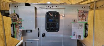

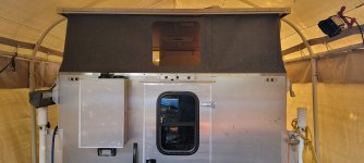

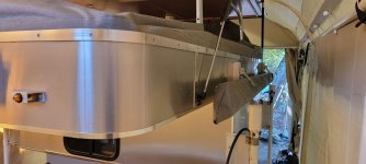

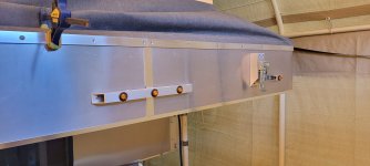

More weekend fun with the camper. I finally (yes finally) got started on the fabric install, and it went pretty well considering I did it solo. Clamped it in place where the join is... just over the rear door, and stretched it all the way around the tub. I lined it up and used 3/4" stainless staples from my air nailer to get it fitted. Once that was done and I confirmed it was in the right spots and lined up properly, I set about installing the aluminum trim I had pre-fabbed for the bottom. This will not only hold it in place, but protect the fabric. That took a bit to do. Looks pretty good I think.
Trim turned out great, exactly like I wanted it to. This long edge however is a bit wonky. I hit a few screws when installing the pre-drilled trim, so had to wiggle it around a bit. Also still need to trim some excess fabric off the bottom in a few places.

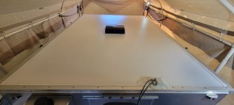

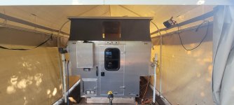

Oh and here is a finished shot of the roof with the panels installed and the wiring all in place held down by Eternabond.
Tomorrow I finish attaching the top and then test it in the truck with the whole thing ready to go. Maybe a test camp next weekend?
