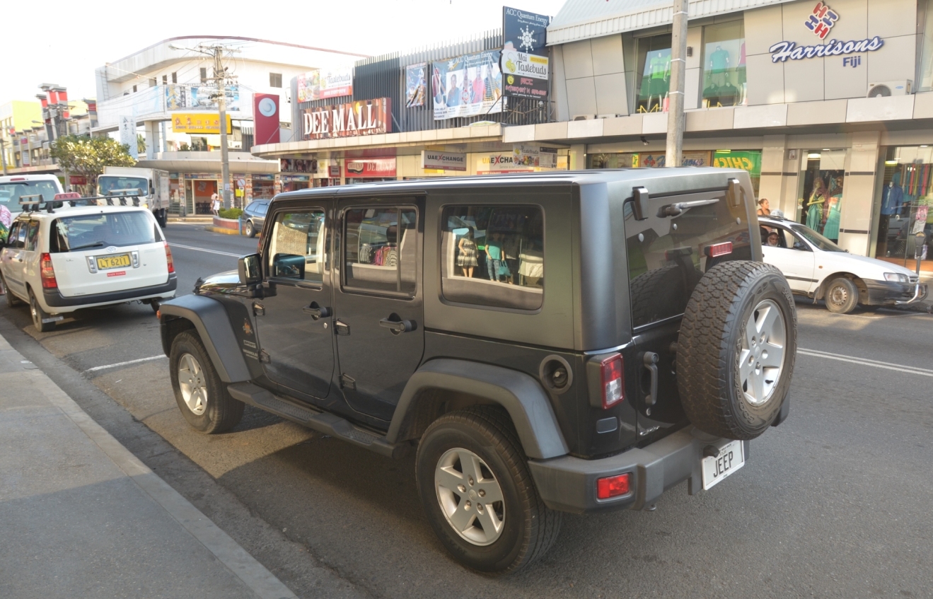

heres mine, 2007 JKU on 285/70 17 Mud Terrains.... ill install a 2.5" lift in a couple of weeks, and then the interior mods will begin, as its designed more for camping and fishing than for wheeling....
