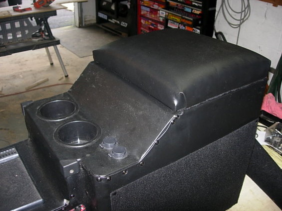

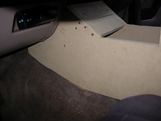

Bronco Center Console
I just finished building a center console for my '96 Bronco. It has and aftermarket seat, which had a center seat section with fold-down back. I never planned on using it as a seat, and the "cup holders" were absolutely terrible. I wanted a higher arm rest, better cup holders, and more storage. I removed the center section, which exposed the seat bracket:
I built it out of 1"X12" boards and covered it with rubber-backed carpet from Lowes.

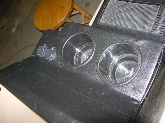

I used a two-cup adjustable cup holder from Autozone. I don't really drink canned soda while driving, so I made it to handle taller drinks (like water bottles), so shorter drinks won't be as comfortable to access while driving.
I used spring-loaded cabinet latches to keep the top snug, and used a 2" corner brace for the lock to engage. Obviously it wouldn't stand up to a serious attempt at theft, but it adds a measure of security, especially if I have the top removed on the Bronco:
I bolted it to the stock holes in the seat bracket. Of course I used grade 8 hardware as this is an Expo rig and anything less would seriously put my manhood in doubt:
I still need to add something more comfortable to the top for actual arm rests. I built it in such a way that adding a little extra height on each side will make it just right. Overall I'm quite pleased with it, and plan on using the same basic materials when I build my rear cargo storage platform:
I took these after dark and the flash really makes the carpet look light; it actually blends with the interior colors quite well. Actual interior dimensions are 16.5" long X 11" wide X 10.5" deep.

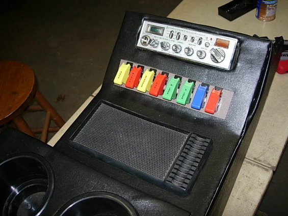

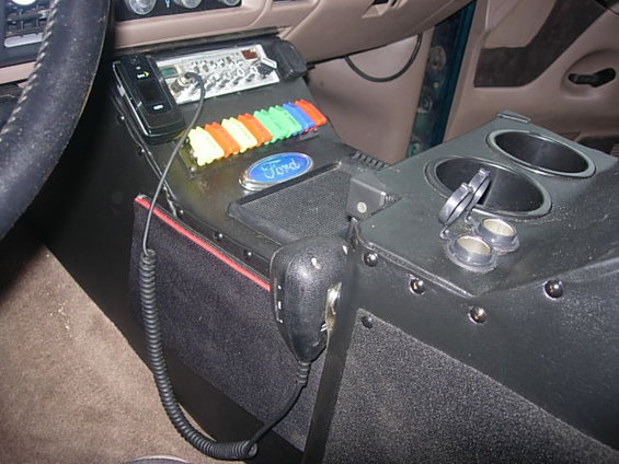

NICE Console, here's the one I built for my bronco. I didnt have the manual 4x4 lever to contend with
I still have to build some sort of matching rear storage :)
Looks great, Accessory Man! I'll add some extras to mine over time, but I needed to get it done fairly quickly for a little trip this week.
