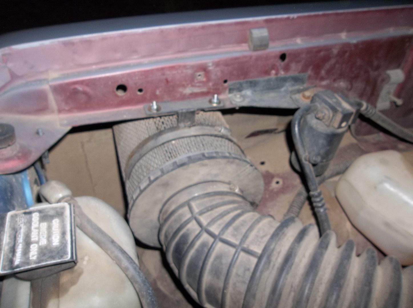

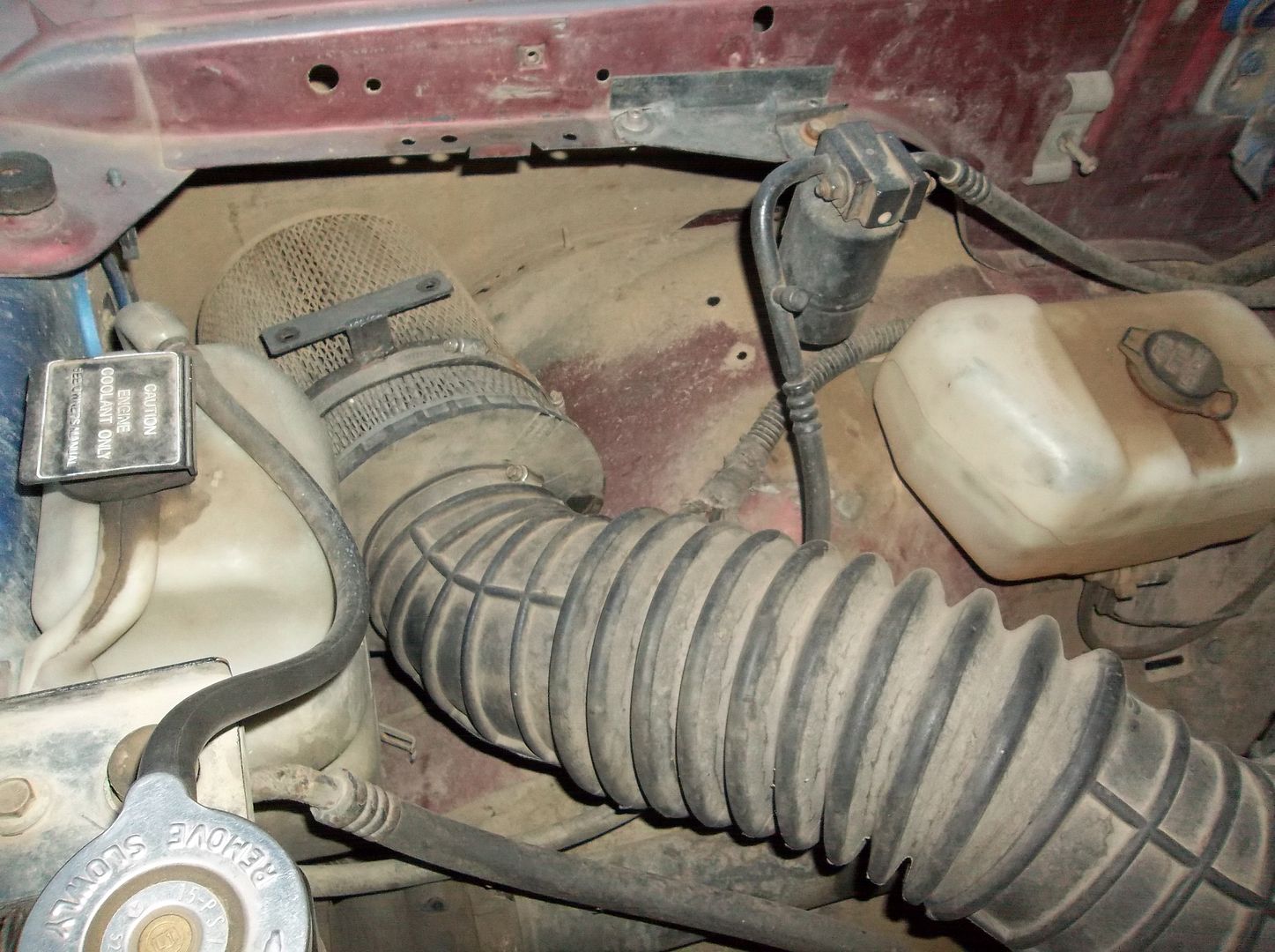

The dang bolts that held the air cleaner bracket in place vibrated loose after 2-3 years....
I replaced them with grade 8 bolts and washers with all metal lock-nuts.....hopefully this doesn't happen every 2-3 years :)
Bummer on the big breakdown. My old dodge had a similar catastrophic event today, a hose clamp was loose.
Simply horrible.
Whew! Lucky you're handy with your tools. Imagine what the dealer would have charged for that fix with a new Dodge. Parts catalog lists them as "Engineered fasteners with rotational, machined attachments kit - $69.95+tax. Book time for installation - 1.5 hours at $129/hr". Next available appointment is the 16th at 2:30pm.
