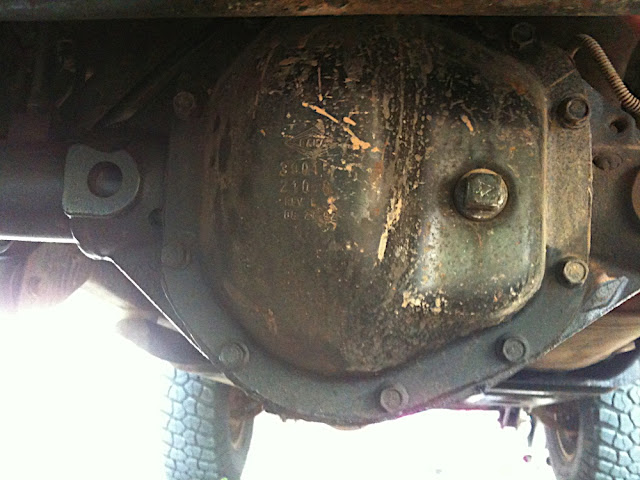

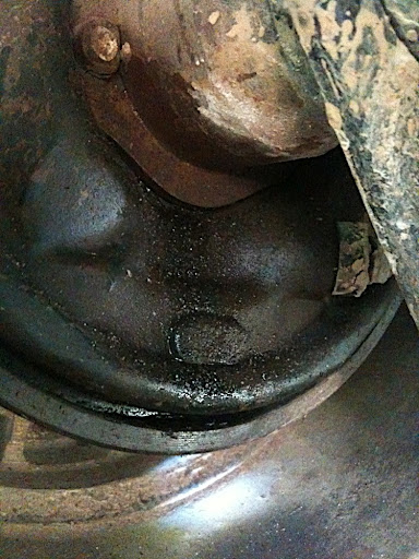

Below are pictures of the diff for identification and pictures of both wheels from the inside. Notice the leaking gear oil on the back of both brake drum units.
I had it parked in a parking spot today with a slight angle to the passenger side. When approaching the vehicle I noticed fluid that had dripped from the hub down the back of the brake drum and down the tire.
I checked the brake flid level and its fine, that was my first thought. Then upon further inspection, feeling and touching I determined it to be gear oil.
I have not checked the fluid level in the diff yet but I have now noticed that there are signs of gear oil leaking on the back of both driver and passenger side rear wheels.
Do these normally laek a bit or is it possible that both rear wheel seals are leaking and or blown?

Also,
At first I was thinking that the local mechanic would have never touched the seals since the axle arrived assebled but now I am realizing that if he installed the new gears he would have had to back the axle shafts out and could have fouled the seals. Is this possible?
The work was done July 10 of 2009, just over a year ago and not even 700 miles of use.

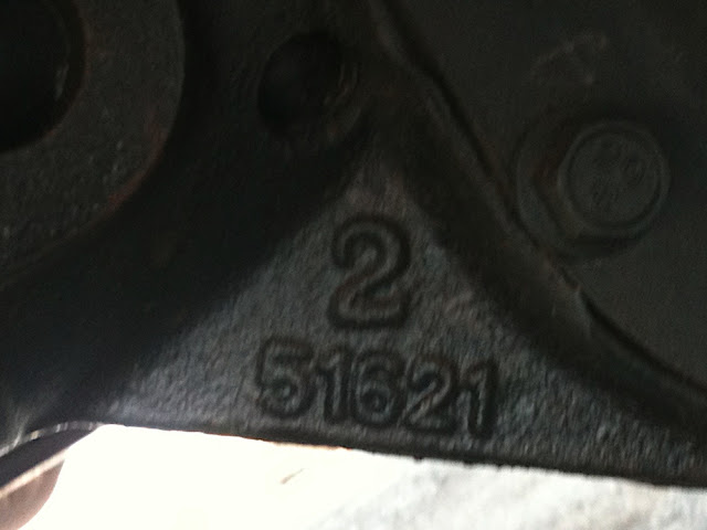

Here is a picture of the numbers on the axle for futher ID.
I must admit I am getting a bit confused as some state the seal and bearings are pressed on to the shaft and others state that they are in the axle housing.
I guess I won't know till I open it up since there are different designs for different years.
So,
Can anyone accurately identify the year of this axle using the images below?

There should be one more number on that axle and I can look it up, the BOM is along the top of the axle usually.
anyways, there is no reason for it to be leaking after only that much driving unless the ARB was installed incorrectly and it is pressurizing the axle housing when it activates the locker. Or if your dad left the jeep in mud for an extended period of time, like while stuck. in that case sand may have found its way in and eaten the seal...but doubtfull
