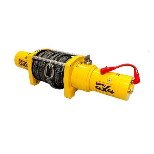

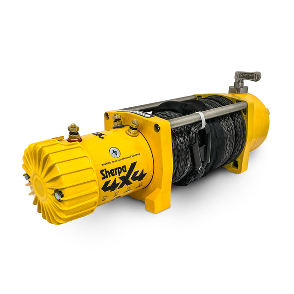

What are the specs on that winch? I’m planning on a elevator bed as well and am trying to source an appropriate motor/winch.
Did someone say winch...
Oh wait... to lift the bed, rather than the Truck. 8.9 hp would be excessive to lift a bed.
Edit... although this would be better for our rigs.
It’s just an cheap 2000# atv winch. The gear boxes on a winch are noisy but since the duty cycle will be so low I’m just going to try to load insulation around it. The speed on it is perfect.
