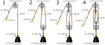

If you rig it right you may even be able to pull it out by hand.
What you have to realize is that if you are using a 2:1 mechanical advantage you will pull 10 feet to move your load five 5, 3:1 you will pull 12 feet to move your load 4 feet, 4:1 you will pull 12 feet to move your load 3 feet.
You do not gain true mechanical advantage by using snatch blocks or pulleys unless they are within the system or rigging, not at the anchor points. Pulleys at the anchor point are only good for change of direction.
