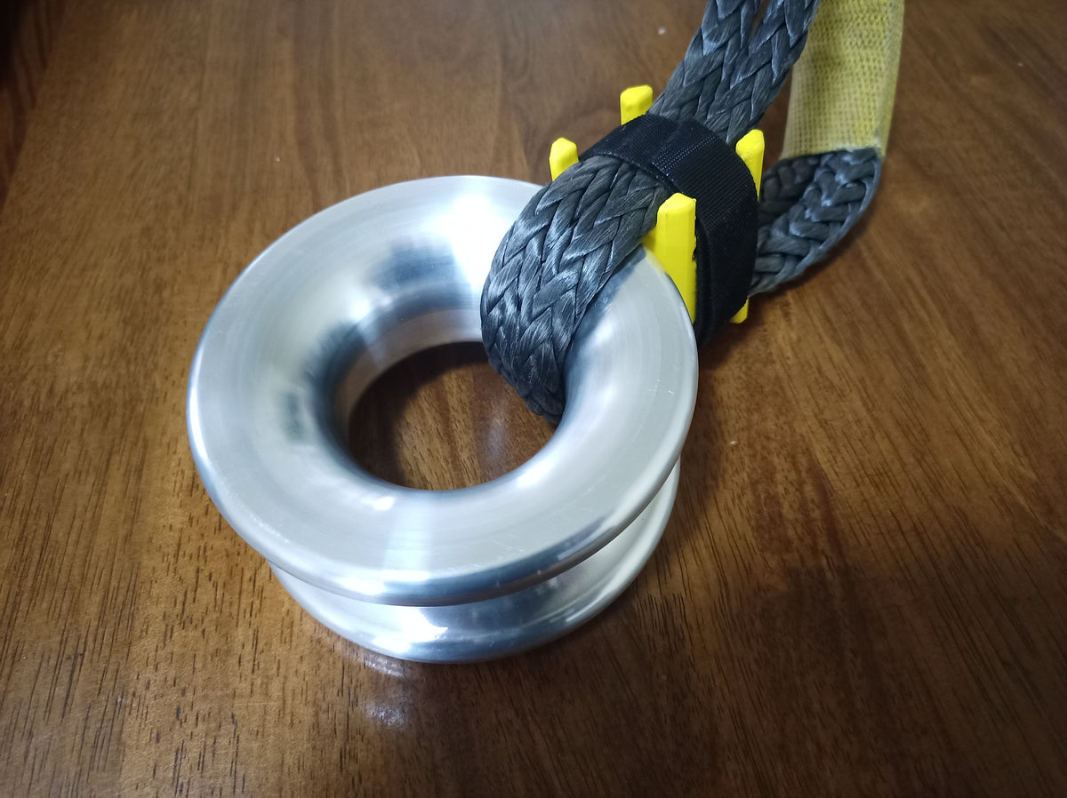

Let's talk about the concept of being able to double rig recovery rings for 4-5:1 mechanical advantage
I've gotten asked a lot since releasing my own Recovery Ring design why I made it a chunky 2 inches thick with such a large center hole and gentle ID radius, well this is ONE of the reasons why. I know this is going to be controversial, but this technique will allow a 4 or 5:1 mechanical advantage with only two Recovery Rings and no winch extension required like in a Spanish Burton. In order to do this safely, the Ring soft shackles will have to be increased in load capacity. ( And we will be providing this option in the near future) The forces this system can generate are amazing if you have a slightly underpowered winch and\or are in a situation where you are very close to the anchor\load and require much more force than a traditional single pulley can provide. Is this going to be a super common use practice, no. Does having gear that can accommodate these techniques add value to already amazing quality gear, absolutely! The only real 'catch' is that you have to be able to fit the end of the winch line through the center on the ring.....you can do that right?

Being able to rig more mechanical advantage is never a bad thing, especially without needing additional gear. It gives you more options. This isn't going to be a every day type technique, but it is something of value to know that your gear can be capable of.
One thing I am dying to try this technique on is rigging it 'off' the vehicle. Situations where the ring one would be uphill across the road....ring two attached to the vehicle in trouble. I can then feed into the system inline with the road, or slightly uphill, but generate a significant advantage to be able to pull a vehicle sideways back onto the road. ( But with limited input force causing less winch vehicle sliding )
Being able to swing up in weight class with the winch vehicle tied off to something. This will help smaller lighter vehicles recover larger vehicles.
I'd also like to try this style setup for backwards winching.
All these possibilities weigh nothing extra.

I also offer the ring alone, but I HIGHLY suggest getting the entire package so everything works the best it can.
My ring was designed with a 2.16" center hole, to make this type of rigging possible. You can pass a normal 1/2" tube thimble, but not one of those big chunky bits that that are pretty common these days. I have moved onto using a soft loop or soft shackle on the end of my winch line on all my personal vehicles to make this much easier. The soft shackle can then be connected right back to the ring when rigging a 4:1. My ring is also a full 2" thick to provide a more gentle radius when working the 'short' direction through the middle.
If you plan on experimenting with double rigging, I suggest picking up a 2nd soft shackle for each ring to increase the overall load capacity. Double rigging rings can put a LARGE load on them and that load should honestly be distributed to multiple anchor points whenever possible. If you only have a single anchor point, I still suggest doubling up the soft shackle when double rigging. This makes it possible to keep a 2:1 minimum FoS when dealing with an ~10k winch.
If you have any other questions, please let me know.
