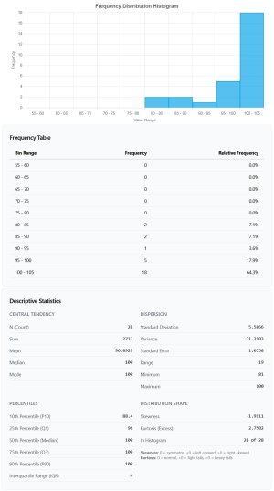

The histogram of maximum daily SOC over the most recent 28 days (February) shows values ranging from 81% to 100%, with 24 days between 90% and 100%. Full charge (100% SOC) was often reached around midday. These results confirm adequate solar capacity under February conditions - one of the lower-yield periods due to shorter days, lower sun angles, and frequent overcast. Performance should improve in March and April as insolation increases. The system met and exceeded the design objective of providing at least seven days of autonomy using solar alone, sustaining operation for the full 182 days.

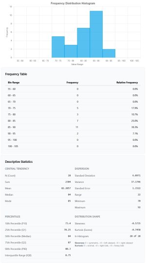

The histogram of minimum daily SOC for the same period ranges from 70% to 92%, with 18 days between 80% and 90%. Minimums typically occurred just before sunrise. The design target was to keep SOC above 25% under normal use; the lowest recorded value of 70% (with all others higher) indicates strong margin and reliable performance.

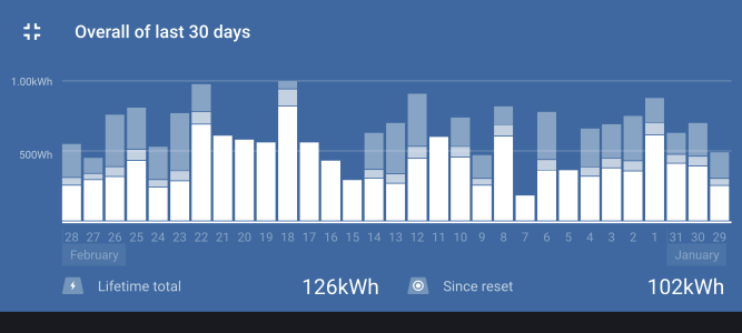

The screenshot below, captured from the Victron Energy solar charge controller, displays the energy collected by the system over the past 28 days. The white portion of each column represents the percentage of time spent in Bulk charge mode, while light blue indicates the Absorption phase and medium blue denotes the Float phase. The data shows that the system reached the Float phase on 79% of the days. This indicates that the system was fully charged for approximately four-fifths of the time.
This period represents one of the lower solar resource times of the year, with reduced exposure duration, oblique rays, and higher chances of overcast skies further diminishing power production from solar panels.

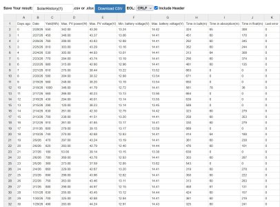

This data is associated with the chart above. I attempted to attach the CSV file to this post for further review but the uploaded file does not have an allowed extension.
