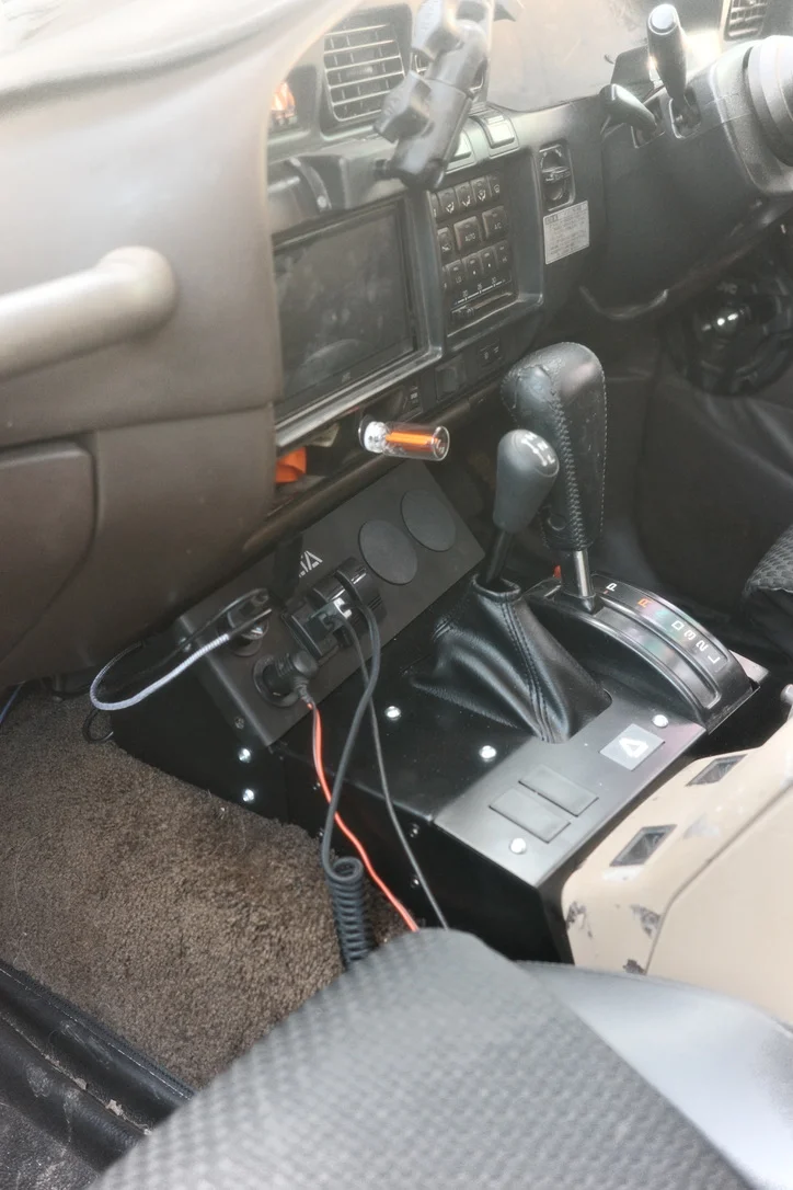

Delta console installed. No idea what I'm putting in for gauges, but it looks a lot better than what was there.

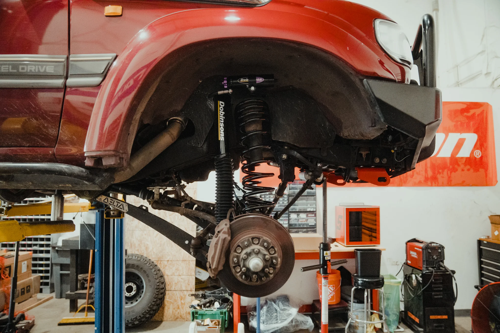

Finally got these CEIKA big brakes installed on the 80 Series. Went with 345mm rotors, 6 XL pistons, slotted rotors, and street pads with the black anti-corrosion finish.
I upgraded for more stopping power after moving up to 37" tires. The install wasn’t exactly plug and play since the kit doesn’t have 80 Series specific instructions. It took some trial and error on the first side, but once you figure it out, the other side goes quick.
The stopping power is a big improvement. Pedal feel is about the same, so it’s probably time to swap the last of my rubber lines to stainless and really dial it in. I already have a rebuilt booster and a new master cylinder, so stainless lines are next on the list.
Shoutout to Offroad Toy Outfitters in Vancouver for letting me document the whole install. I’ll post a YouTube video soon if you want to see how it all went down.
My only gripe is the lack of clear instructions. For around $2k, though, this kit is hard to beat.
