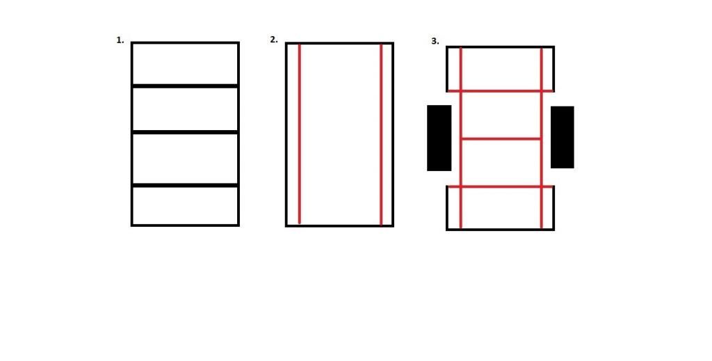

FRAME REVISION
Well I've been considering making some changes to my trailer frame. I want to reduce my wms to wms from 65" (with wheel spacers) down to 58" to match my 4runner. Here's what I'm thinking for the frame.
1. Cut out the crossmembers
2. Weld in the new lateral frame rails
3. Weld in the crossmembers, tie into the original outer frame. Once that's done cut and remove the portion of the outer frame where the tires will be. Cut out the tub to accommodate the tires. Build some wheel wells for the tub.

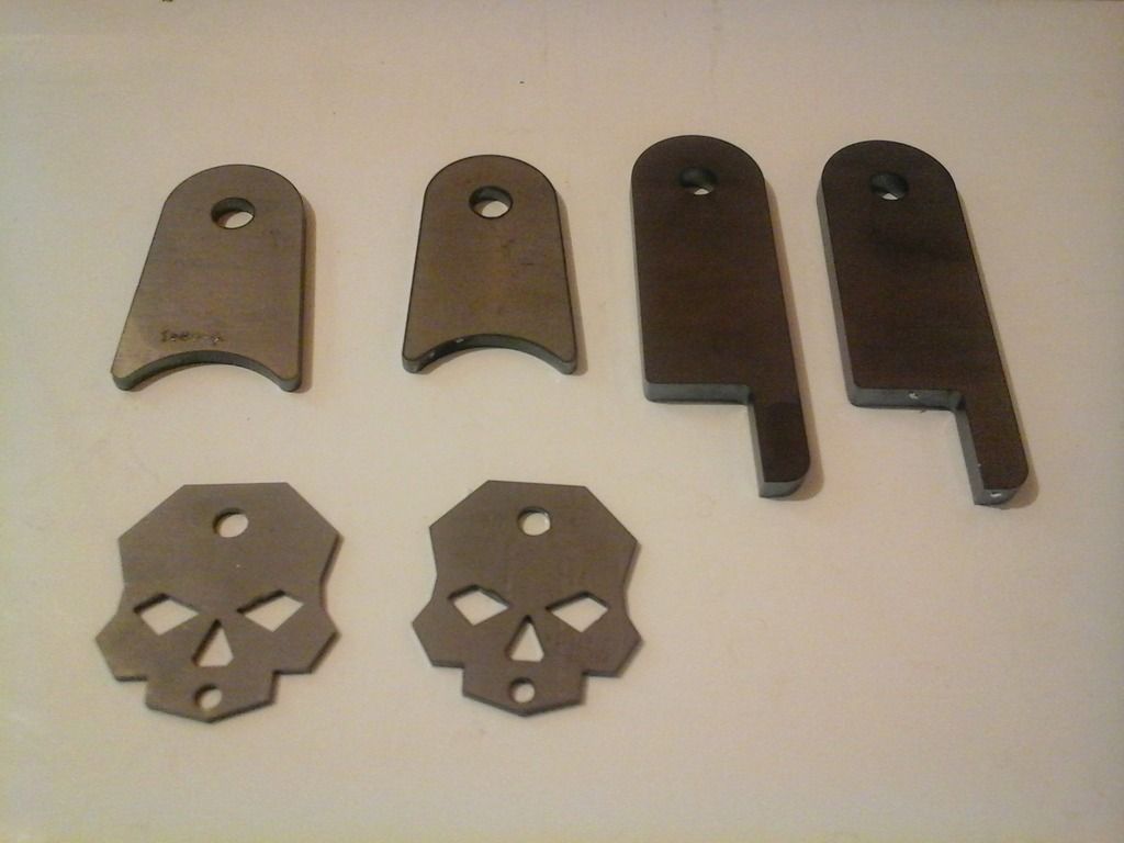

I ordered some tabs to finish up the 3 link, two for the axel and two to go to the frame, got them through Ballistic Fabrication. I will be ordering the metal for the lid hopefully tomorrow, think I'm going to go with a 5x10' sheet of 16 gauge to skin the lid, and 1" square tube for the frame, I should have plenty left over to build some fenders. My days off are Monday and Tuesday, so hope to have a better update next week.
*Edit* I just noticed that the tabs I was going to use for the frame to attach the link to is 3/8 thick instead of 1/4...shouldn't be a problem as the hole is still 9/16". Also I couldn't order the sheet metal and 1" tubing yet. My brother sent me the money via PayPal, and it is going to take 5 buisness days for it to transfer to my bank account...that's kind of ridiculous!

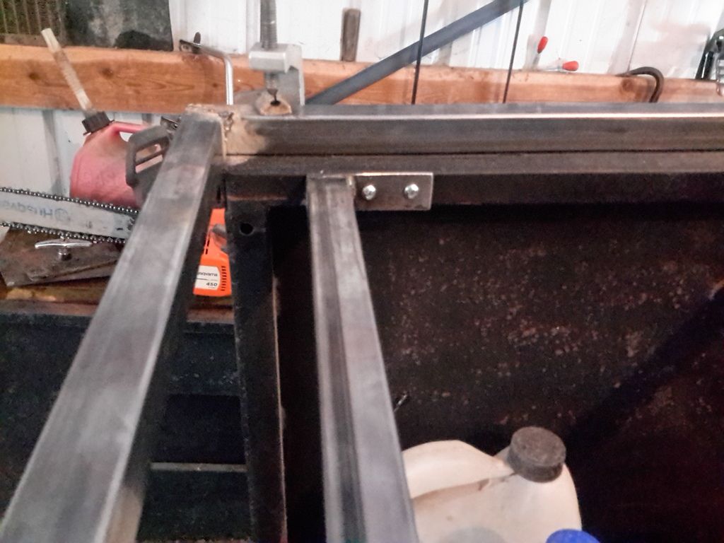

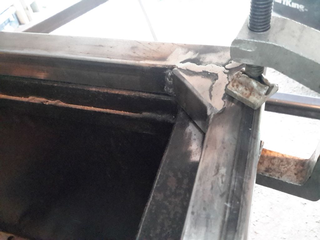

I got a little done today on the trailer lid. Started building the frame out of some square 1" tube. I decided to keep it simple and just make it flat. Got it all tacked together.
^^^I messed up a little when I welded in this gusset, I should have waited until I had all of the stringers in, and then weld in the gusset a little at a time, but I burned it in and warped the corner pulling it in and out of square some. I was able to minimize it when I put the stringers in, and it's not as noticeable as before.
Anyone have some tips or advice for skinning the lid? I was thinking of starting by welding short beads starting in the middle of the lid on the stringers and working my way from the center out, I'm hoping that would prevent the lid from warping further, what do you guys think?

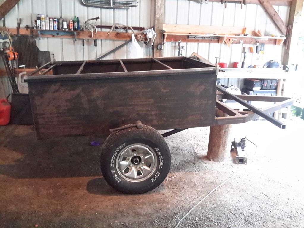

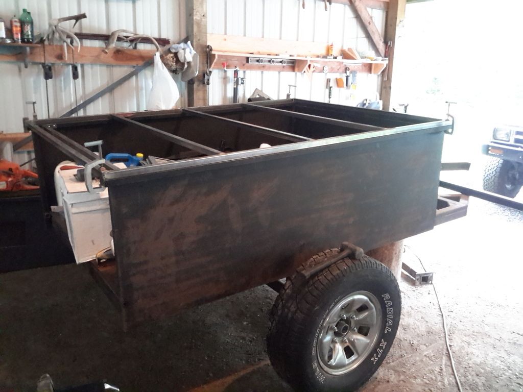

I got all the parts cut out to build the fenders today, it's alot faster now that I finally have a metal chop saw, with the exception of the work i did the last 2 days on the lid and fenders, everything else was cut with a 4-1/2" Mikita grinder.
Here's a couple pics of the tube fenders, I only got the driverside tack welded together, I also built side steps that will go in front of the fenders, didn't get any pics of those. Not sure if I'm going to put steps behind the fenders yet, I might put Jerry can mounts there instead.
