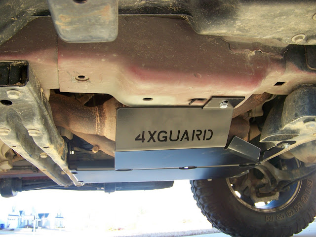

Sal-XK
4xGuard Skids
I mounted 4xguard front skid and belly guard as well as recovery hooks today. The front skid finished my trimmed bumper off real nice and my cats are protected now with the belly guard.
It's getting there I have a lot more armor upgrades I need to do but slowly getting there. :)

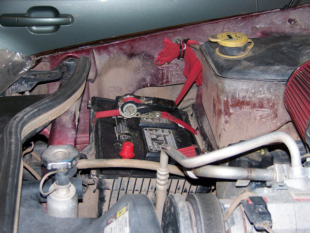

Sal-XK
Second Battery
Well got the wife a new yellow top today which meant I got her old battery. So I started carving up the stock air box to fit the wifes battery in it. :( what a pain in the butt if I would of got a yellow top for myself it would of slid right in. LOL Any way I got it trimmed up then broke it after trimming for about 30 minuets. LOL Anyway I got it installed I'm not satisfied about the box, I think I'm going to get a shelf welded in to hold the batter instead. Anyway here are some pics I didn't get around to wiring it up yet. I'm going to rewire the XK from scratch and run all my accessories to the spare battery.
My dremel setup I love this little thing great tool
Trimmed up air box
I'm considering this mount temporary thats why I didn't cut the end of my strap yet and just tied it up.
cico7
I have considered that same location. Walmart and other places sell battery
boxes. The is somewhat of a tray there I think you could mount the box to.
I would get a battery isolater and select switch....marine dealers would carry
those. what is on the other side of the shock tower? If that is that still empty
you could use a radio shack project box
6 x 3 x 2 (270-1805) and mount 4 12VDC/40A SPST (275-001)
Automotive Relay's in it.
I would screw the front on and glue it the cut the top off and hinge it.
That would power driving lights and back lights. Also attach your power inverter
to that battery.
